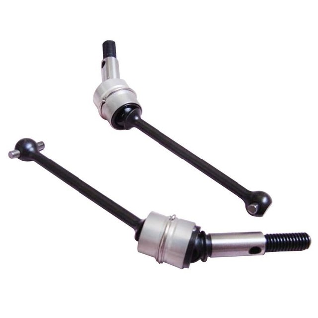

I agree with you 100% from a technical perspective.  At the same time, there is a universal joint marketed as a "CVD," and generally people have a mental picture of what that looks like.  If you search on the web for "3Racing CVD," "Yeah Racing CVD," "Xtra Speed CVD," etc. you'll see something like this (which is a universal joint):
Search results also show something like this (which is a DCJ):
Then there's the universal joint most people think of and is functionally similar to the "CVD" shown above:
So, yes, I agree that a "CVD" is really a "universal joint" technically speaking.  At the same time, the manufacturers have chosen marketing terminology to distinguish the appearance of two universal joints.
It's still the case the dogbone is the sloppiest solution, with universal joints (either true universal joints or "CVDs") reducing some slop, and finally DCJs being the best.
Thanks for pointing this out; hopefully this clarifies things for everyone.
