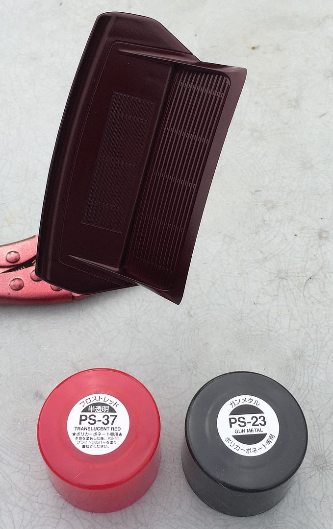

Shodog 1835 Posted June 20, 2020 With the wing on my 934 I used the PS colors in reverse then shot a few coats of the TS clear 6 1 Share this post Link to post Share on other sites
TrueBlue 45 Posted June 20, 2020 You were able to spray plastic with the polycarbonate paints? And it sticks OK.. doesn't flake or peel? So you layered the gun metal then the translucent red? Interesting... in the right light, that colour looks like a close match, might have to give that one a shot. Still contemplating translucent pink and silver, as it might be what I need to give the colour that vibrant pop. Share this post Link to post Share on other sites

Shodog 1835 Posted June 21, 2020 11 hours ago, TrueBlue said: You were able to spray plastic with the polycarbonate paints? And it sticks OK.. doesn't flake or peel? So you layered the gun metal then the translucent red? Interesting... in the right light, that colour looks like a close match, might have to give that one a shot. I sanded and primed the wing with tamiya fine line primer. Shot it with gun metal and let that cure. Then shot the clear red to the shade which matched the body. The more you put on the darker the red goes Share this post Link to post Share on other sites
