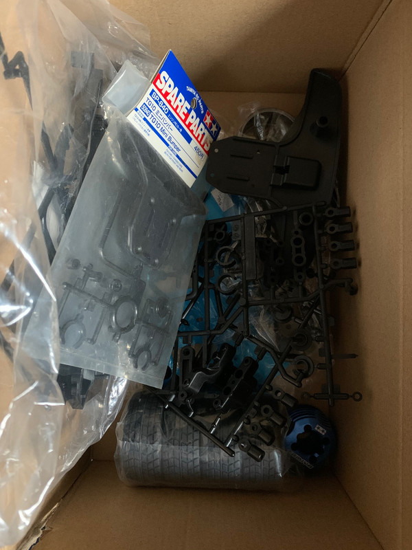

So to start replicating this for my collection I need a few bits, mainly a base chassis and Ebay came up trumps.
I already have the heatsink head and some new parts including a new chassis plate and mechanism tub. Wheels and tyres are on the way so able to make progress quickly.

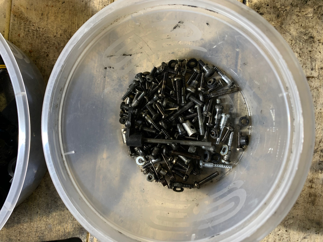

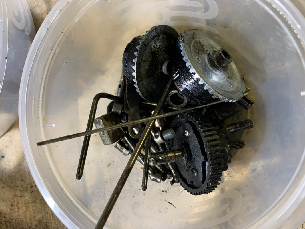

A large pot of screws. All of these will go through the ultrasonic cleaner. Once clean I will then check them over and make a decision on using them or not. Its mainly the chassis base screws that get replaced but it depends on which ones had been butchered by the previous owner. There are a few!

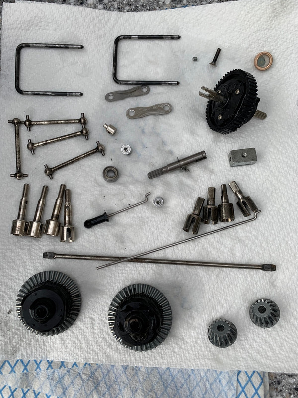

Metal parts. Again they will all be cleaned using the Ultrasonic and then checked over and if need be polished or chemically blackened again.

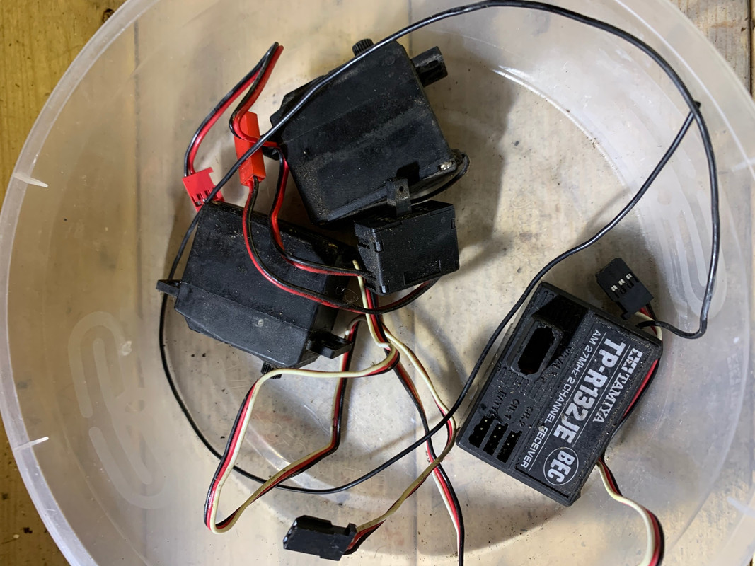

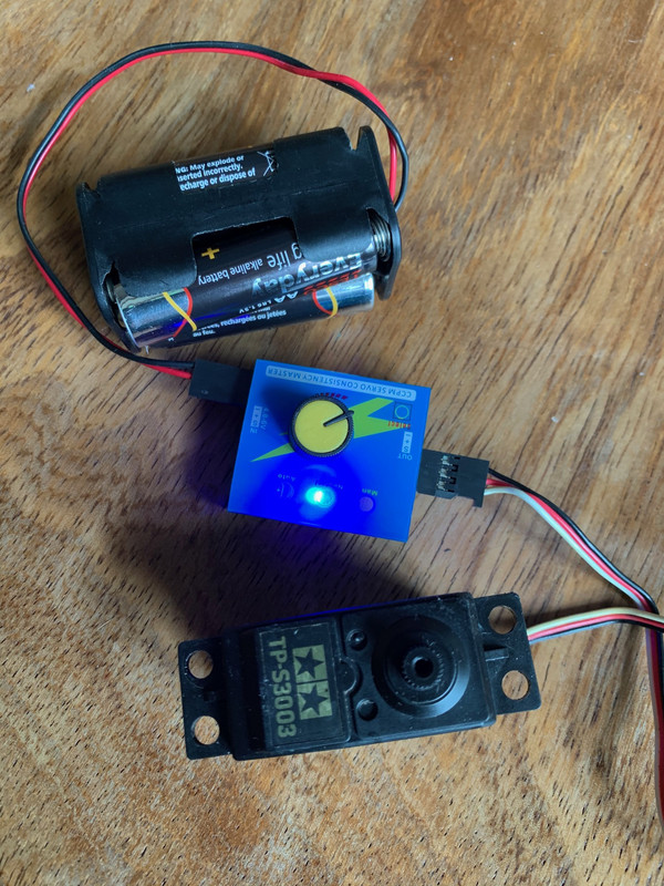

A pot of electronics. Two servo's, an RX and a switch. Everything will be hand cleaned and then tested before going back in

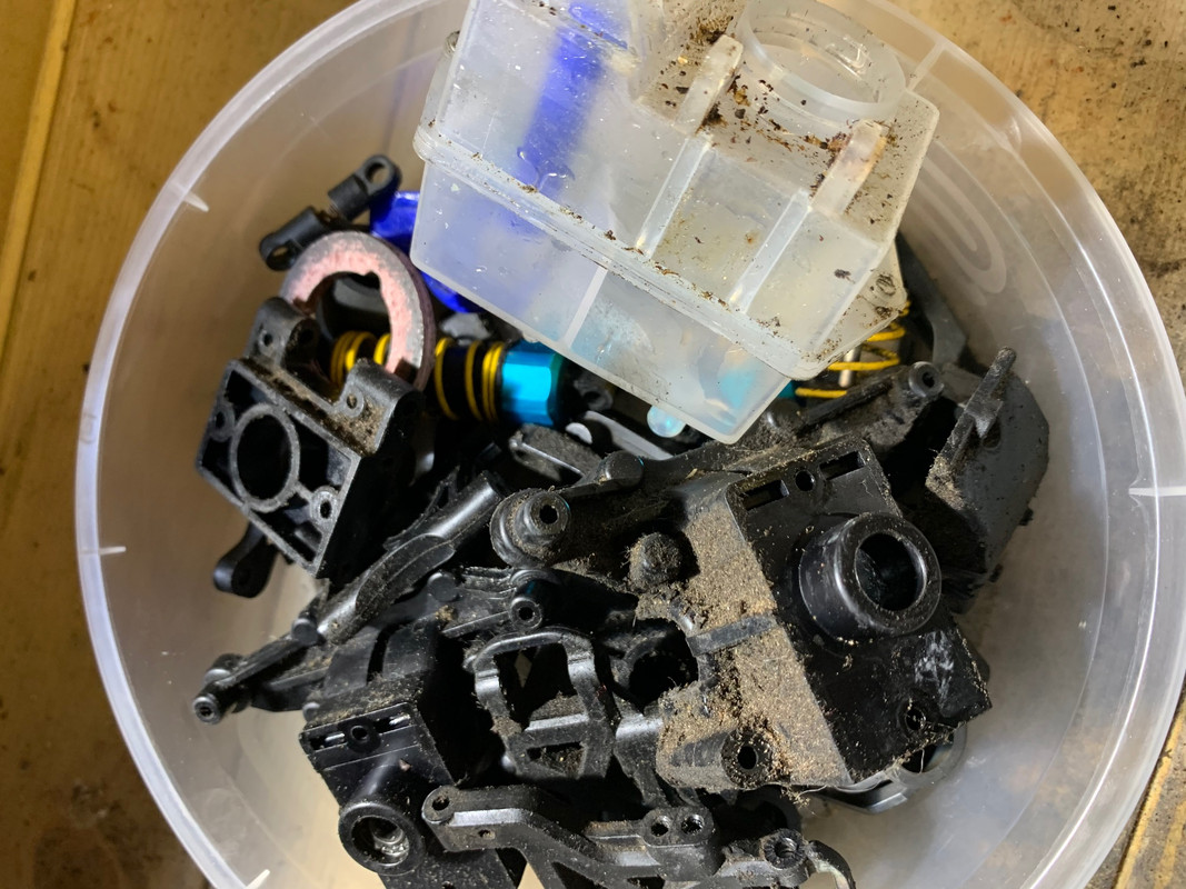

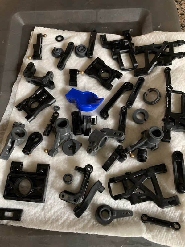

A load of plastic parts that initially I will keep. Will go through the ultrasonic in batches and then be inspected. The lower arms may get replaced due to some scratches. The fuel tank will go in denture cleaner after the ultrasonic. Shocks will be stripped and then cleaned.

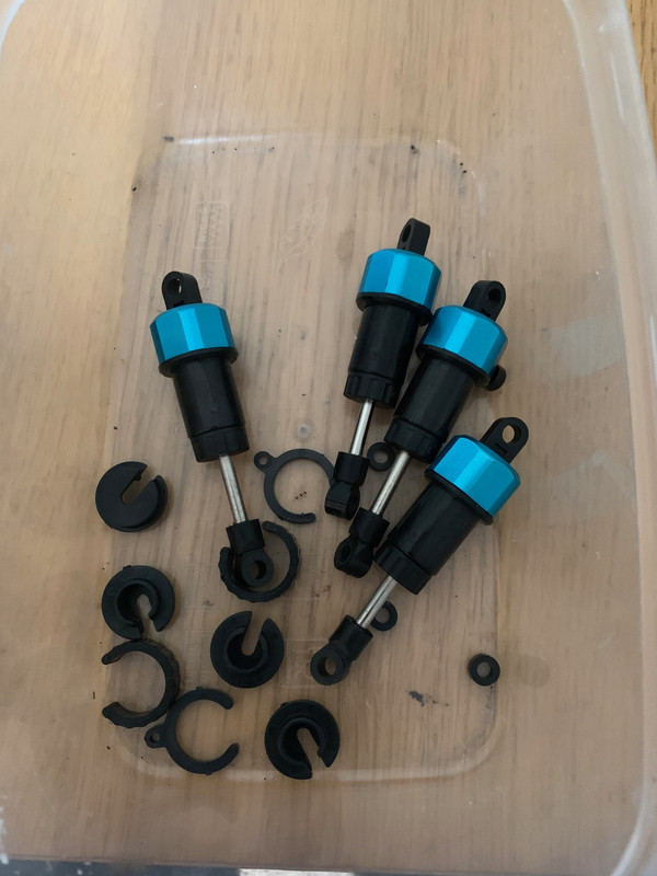

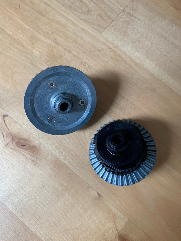

Screws went through the same process with the shocks. Diffs went in again
Now I need to sort the screws and check them over. As I expected looks like the base screws will be replaced. I don't throw them away though, they go in a box for cars that get sold off in case I need any for them. Diffs will be stripped, checked and regreased. Shocks will be stripped and rebuilt. Already looks like I need at least one yellow spring.
Also put all the new bits in a box ready for rebuild. Bumpers, chassis plate, wheels, tyres, radio box and engine head.

Plastic parts have started to go through the Ultrasonic. Only difference is I use standard dish soap on them with water not parts cleaner. The servos and RX have been cleaned by hand
and then the servos have been tested. All work fine

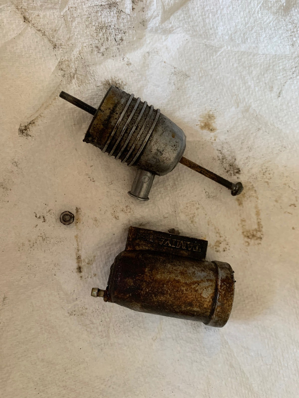

The tank was hand washed to remove loose dirt and has now gone in denture cleaner for 24hrs.

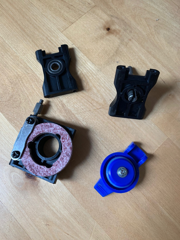

Started building up sub assemblies. New screws and seal on the fuel tank lid, brake assy rebuilt and the front and rear diffs opened, checked and regreased.
Gearbox housings cleaned up ok and will go back on the car

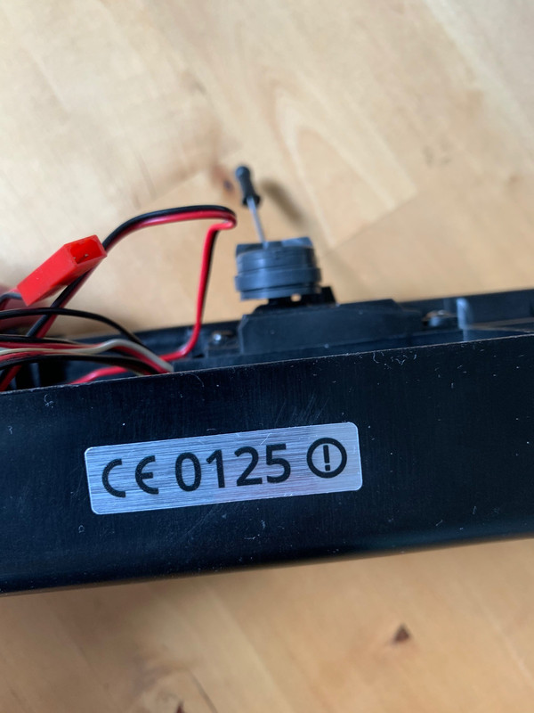

A while ago I reproduced the European CE mark that Tamiya add to all XBG kits imported to Europe. I also added one to the tub

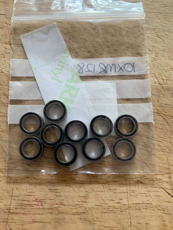

and the extra bearings I needed for the front and rear gearbox

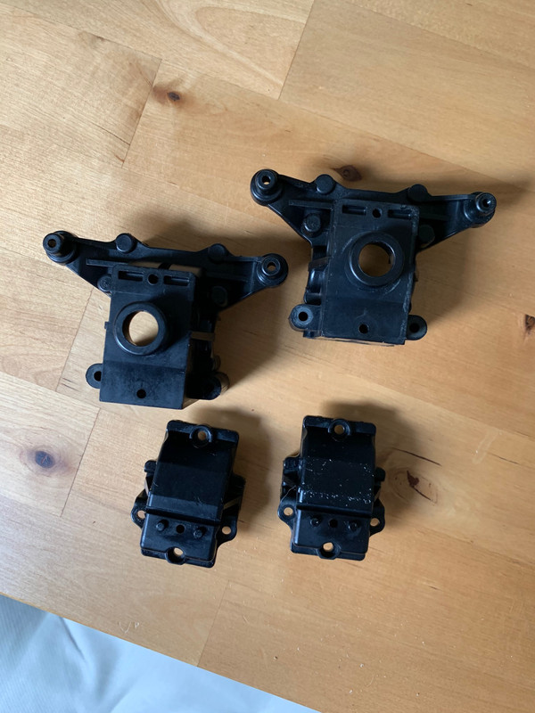

Front gearbox fitted to the chassis along with a new bumper
and the same with the rear gearbox

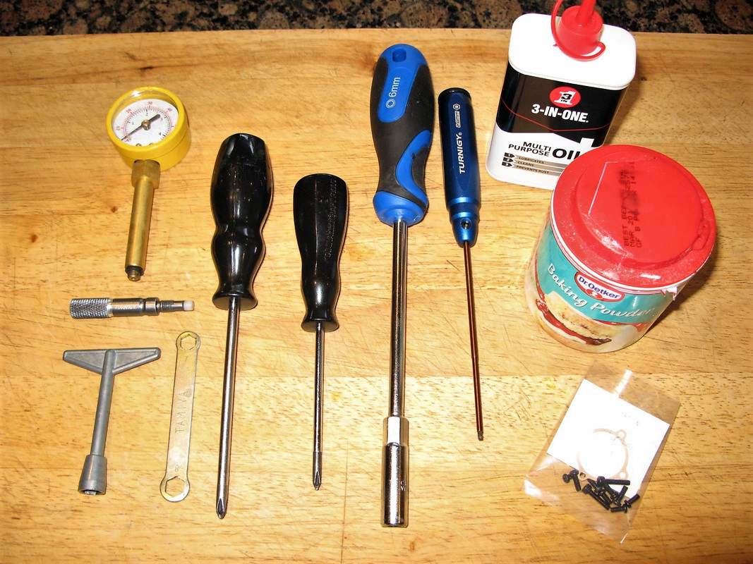

Shocks to do this weekend along with taking the engine to bits. The engine usually needs a few tools and these are what I use. This is a picture from my TGS restoration and I wont need a new backplate gasket for the FD range of cars.

I am so confused by this chassis.
It uses TB01/TG10 gearbox cases, diffs and bumpers with basically TL01LA suspension uprights and hub carriers but not the arms.
Why? Why did Tamiya make these? Were they released before, after or alongside the TG10? Are the XB only or did some come as kits?

For me I think its all about gap filling and cost saving. The kits are all XBG and were only issued ready built. There is about a year between the release date of the last TG-10 Mk1 and the first TNS chassis car. The TNS buggy range came two years later. I think it was simply a case of using mostly stock parts to create a kit that filled the nitro chassis gap for Tamiya until the TG-10 Mk2 came along. The TNS range stopped about a year after the TG-10 Mk2 came out.
The TNS chassis kits evolved and quickly moved from the old TGS engines and switched to the newer FD engines provided by Force. These engines also powered the TNS buggies and the TNX 5.2 and Nitrage. It probably meant sense for Tamiya to have more from Force to keep the costs down. They could also at that point discontinue the older FS-12S and FS-12SW engines.
The TNS range of cars I think was woefully unloved. Not that many in Japan or the USA come up for sale and I think Europe was the main market for them. The buggies are pretty similar with most appearing in the UK and Germany. The French distributor T2M did a yellow body version of the Mad Spirit and these do seem to have made it into the UK. I have one here https://www.tamiyaclub.com/showroom_model.asp?cid=133723&id=4

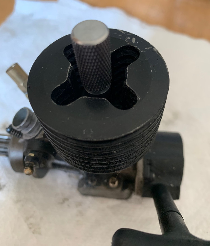

Then the glowplug comes out and the piston locker replaces it. This allows the front end of the engine to come apart.

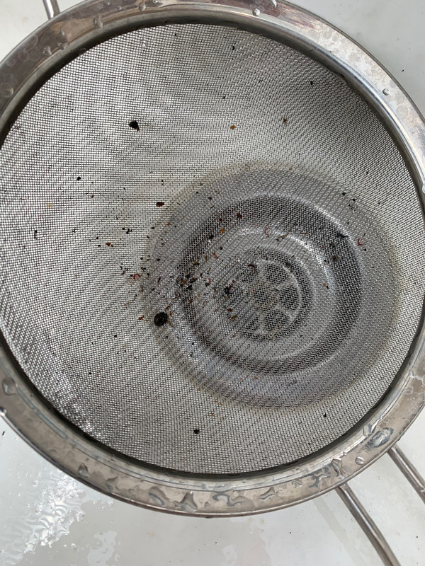

The water was certainly black! This is what it rinsed out of the engine
The engines parts were then rinsed, covered in WD-40 to stop any corrosion and left to dry. Rebuild on that soon

and so the shocks were cleaned, rebuilt and filled with fresh oil.

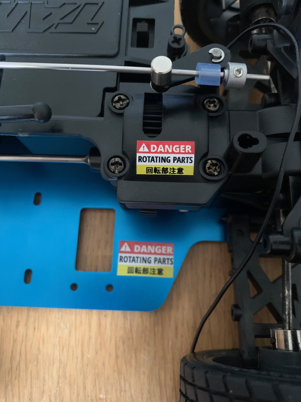

Just awaiting the new springs now. Picked some of my reproduction warning decals
and fitted them to the chassis
