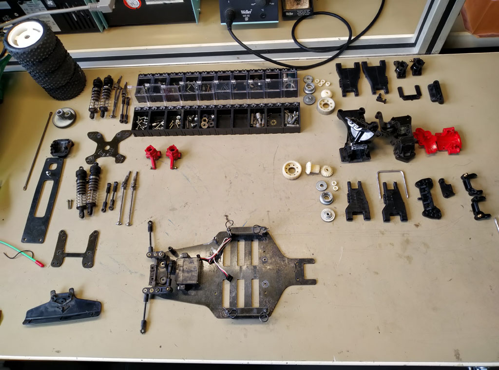

So, after the first shock the car was disassembled and the parts were cleaned in the sonic cleaner.
The car must had a hard life. The front gearbox covers were red, all ball connectors have a lot of play, screws were missing, the chassisplates are yellowed, rear gearbox was cracked, front gears are damaged etc.
Only to list a few.
The plan to build it as a shelf queen is now obsolete. At the moment I think the best way will be to build it as a modified runner. If I would restore it to new, not much original parts will be left.
The first parts were ordered when the car was on it's way to me.
At this stage I thought these were the most parts I need :D
The black front gearboxhousing will be used for my TA02 Racing Special replica as for a runner the black ones are to hard to get.
I will use the silver gearboxes for the runner rebuild. For the FRP Plates I will check if I can produce these out of carbon on the CNC Mill.I also will test if the original Ball Diff aluminium parts could be lighten a few grams :ph34r:
Let me know what you think about my thoughts? I'm open-minded for your suggestions.

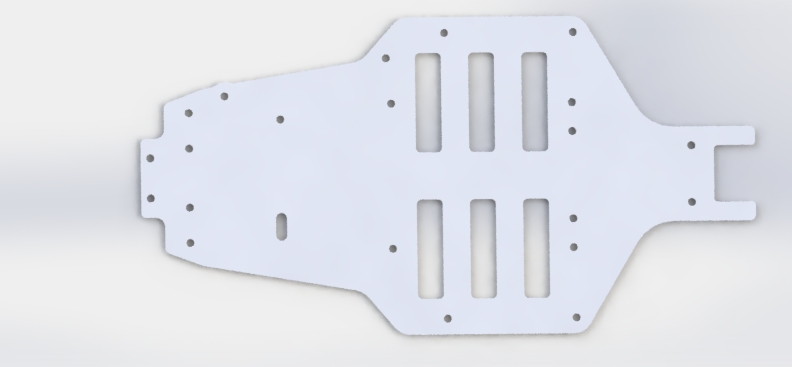

Was a bit creative this week.

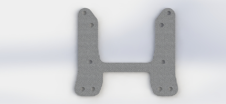

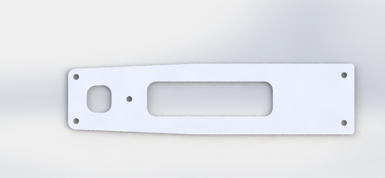

Have transferred the original TF FRP parts in the CAD.
The next step is to alter the design a bit with the inspiration of the Evo etc. The rear damper stay will receive a provision to strengthen the weak 2 screw points.
If it's possible I will put the DXF of the original an modified parts in the forum, so everyone can use it as a base to modify.

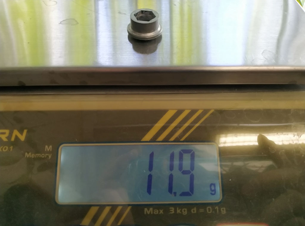

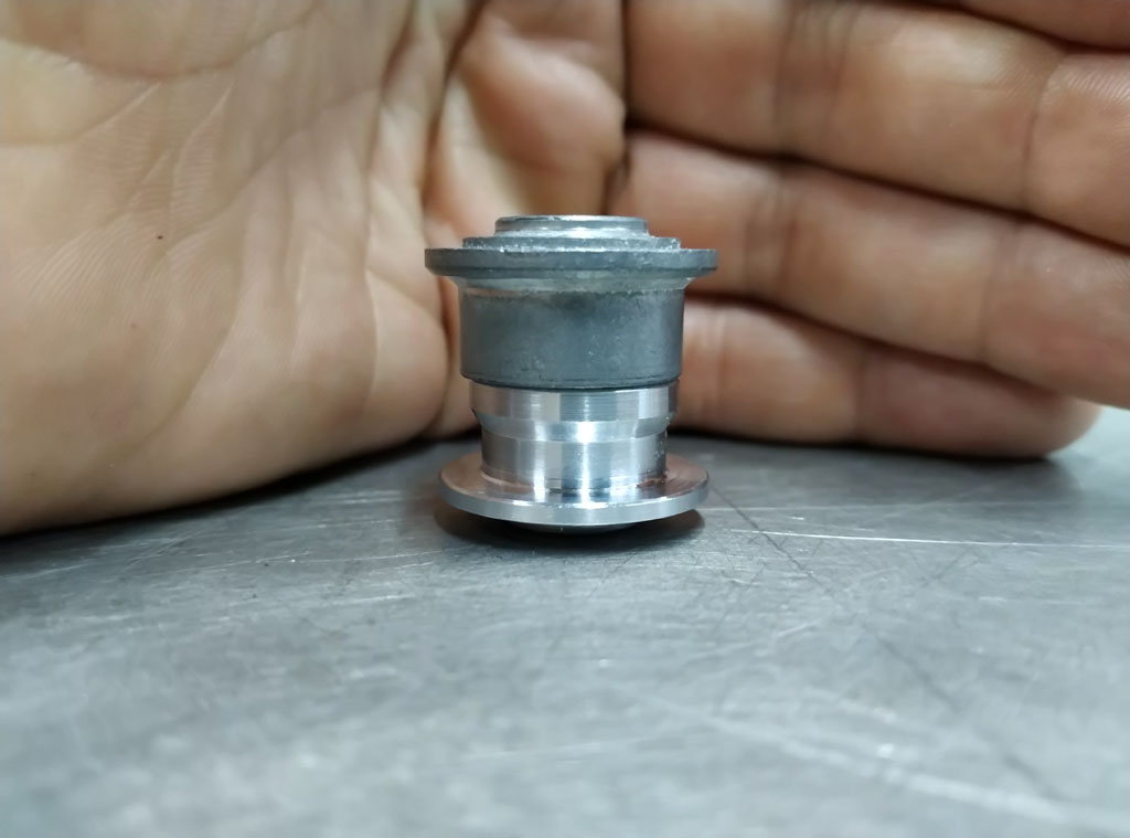

Was thinking a bit how the diff halfes could be improved in weight especially since the TF Evo parts are hard to find.
And some time later...
preview
As you can see, I only saved 3,3 gr. At first I was a bit disappointed, but for only 40 min of work the result was ok.
I was a bit conservative with the wall thickness and if I would use a mill to bring down the material around the hex there would be some grams lost.
I also think the TF EVO Parts are of another alloy.

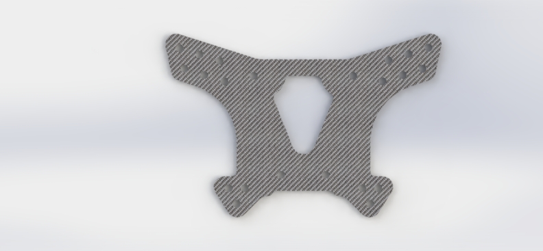

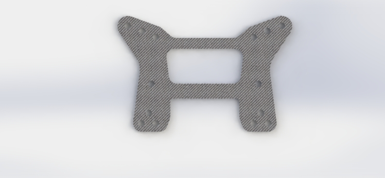

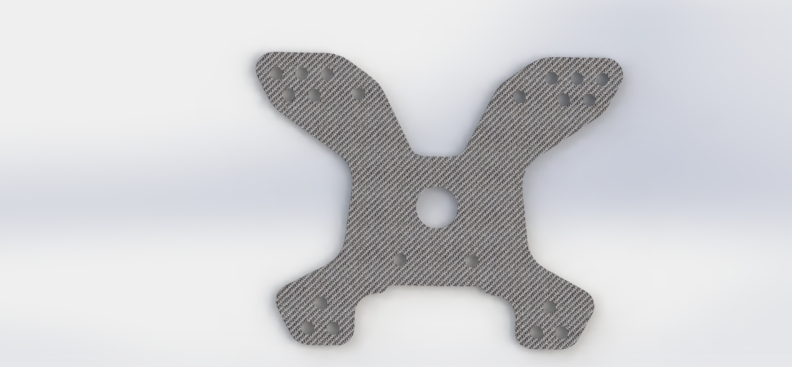

Some days forward I digitised the EVO damper stays I found in the forum.
D%C3%A4mpferbr%C3%BCcke%20Evo%20hinten.J
D%C3%A4mpferbr%C3%BCcke%20Evo%20vorne.JP
Next week I will produce a first batch of parts out of FRP to test the fitment.

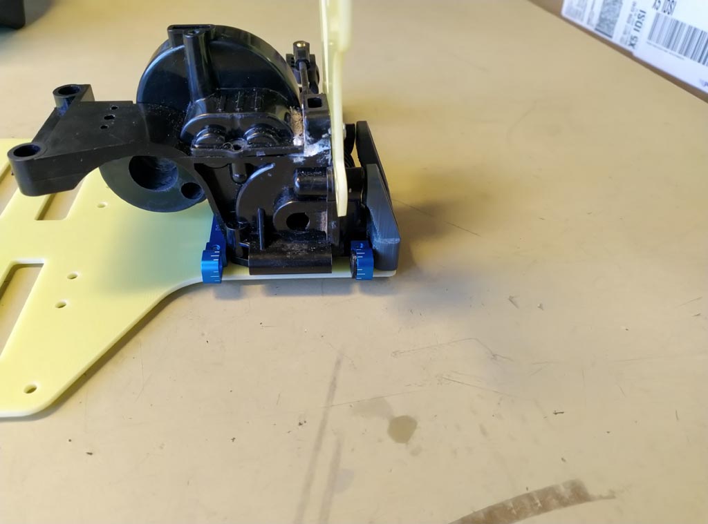

I have assembled the diffs with only this part lightened for now. But with my Ta-02RS replica I will pick that project again. The main problem to produce new diff parts is the toothing of the diff joint.

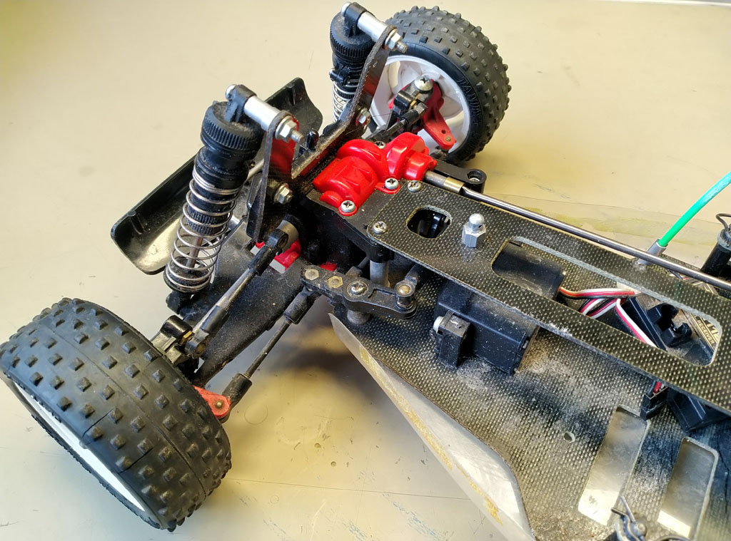

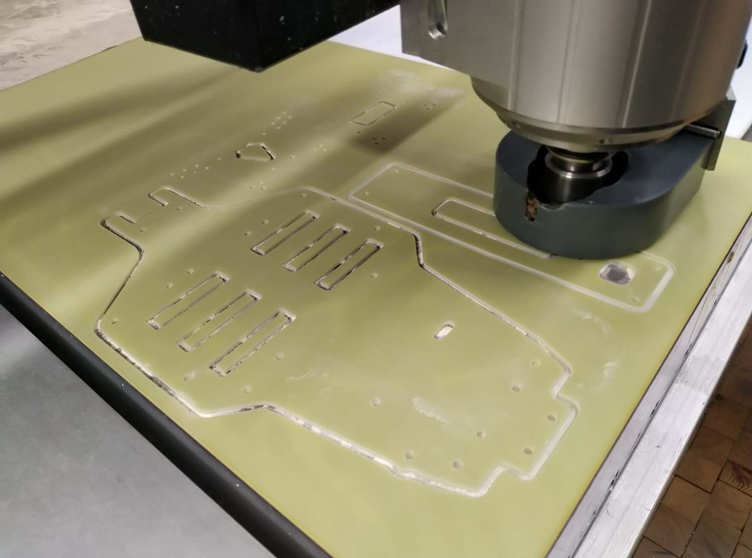

The 3mm cutter arrived today, so after work I fired up the CNC.
Parts fit really well. Only the rear damper mount need minor adjustment.
After assembly of the whole car with no hassle, i will upload the all files to the Forum.
Next steps are to order the Lipo saddle pack from Hobbyking and design a bracket.

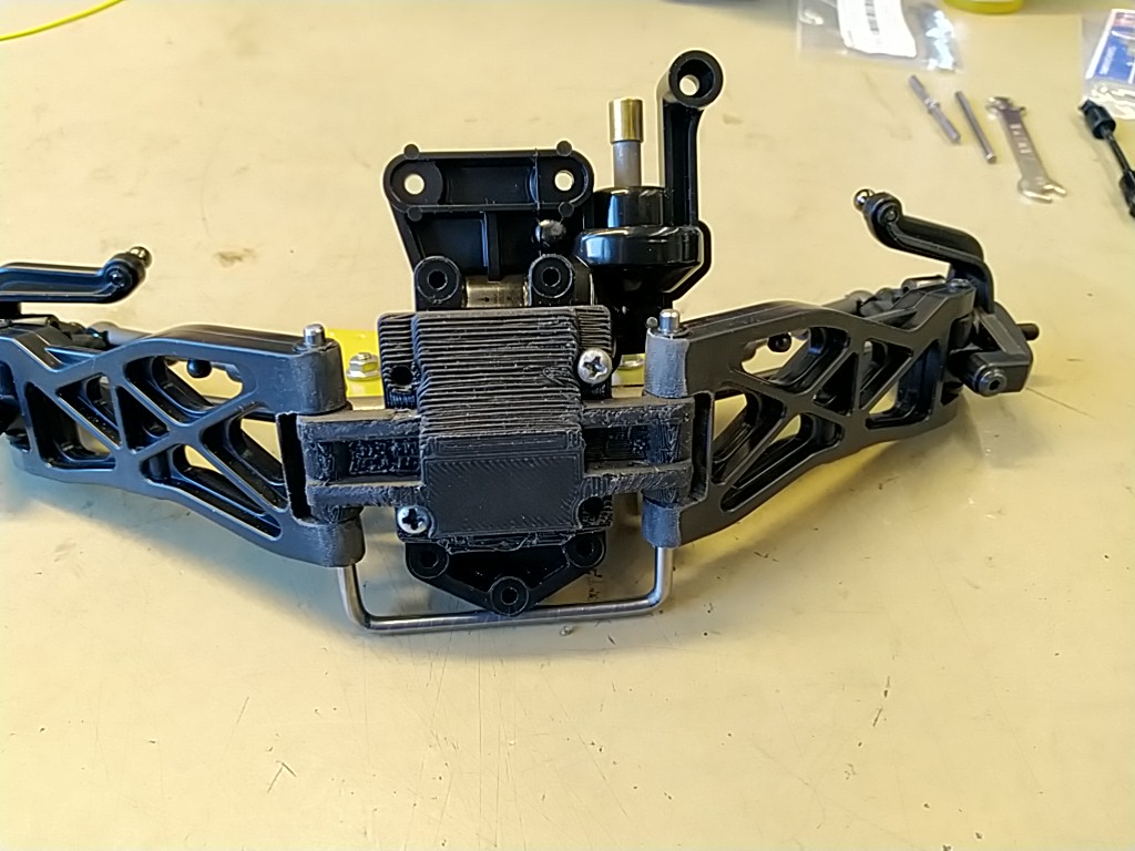

As anybody know, the DF-01 lags the needed adjustability at the rear for anti squat or toe. I missed it at my Manta Ray and the TA-02 Chassis I owned, so for this build I searched for a solution.
When I was randomly searching at the shop of Modellbau Seidel, I found the suspension mounts of the TRF419/420. After some research, the system seems perfect for my needs. A lot of adjustability and different mounts are available. With the next order I added a 54881 adjustable A mount for testing.
After some measuring here is the result ( was good to keep the prototype chassis and the old gearbox :D ).
The front mount was the easier one. At the rear I'm not sure how to mount it. I can extend the chassis or use existing mounting points.
Extending the chassis will be much neater. Using existing points made it possible for other users to modify their TF (if anybody, except for me, need this mod :rolleyes:) I think I have to design both to choose the right one.
Let me know, if you have any suggestions and your opinion.

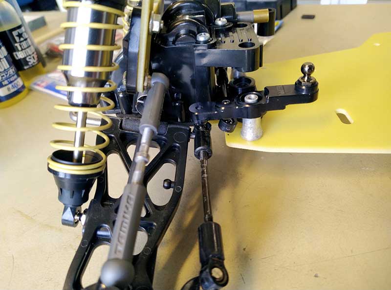

Some progress on the Top Force.

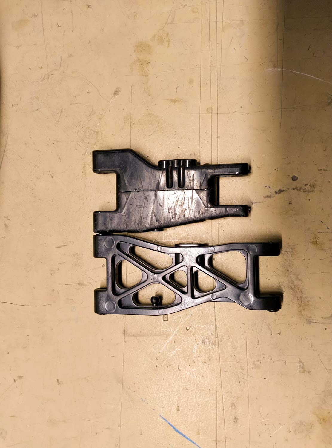

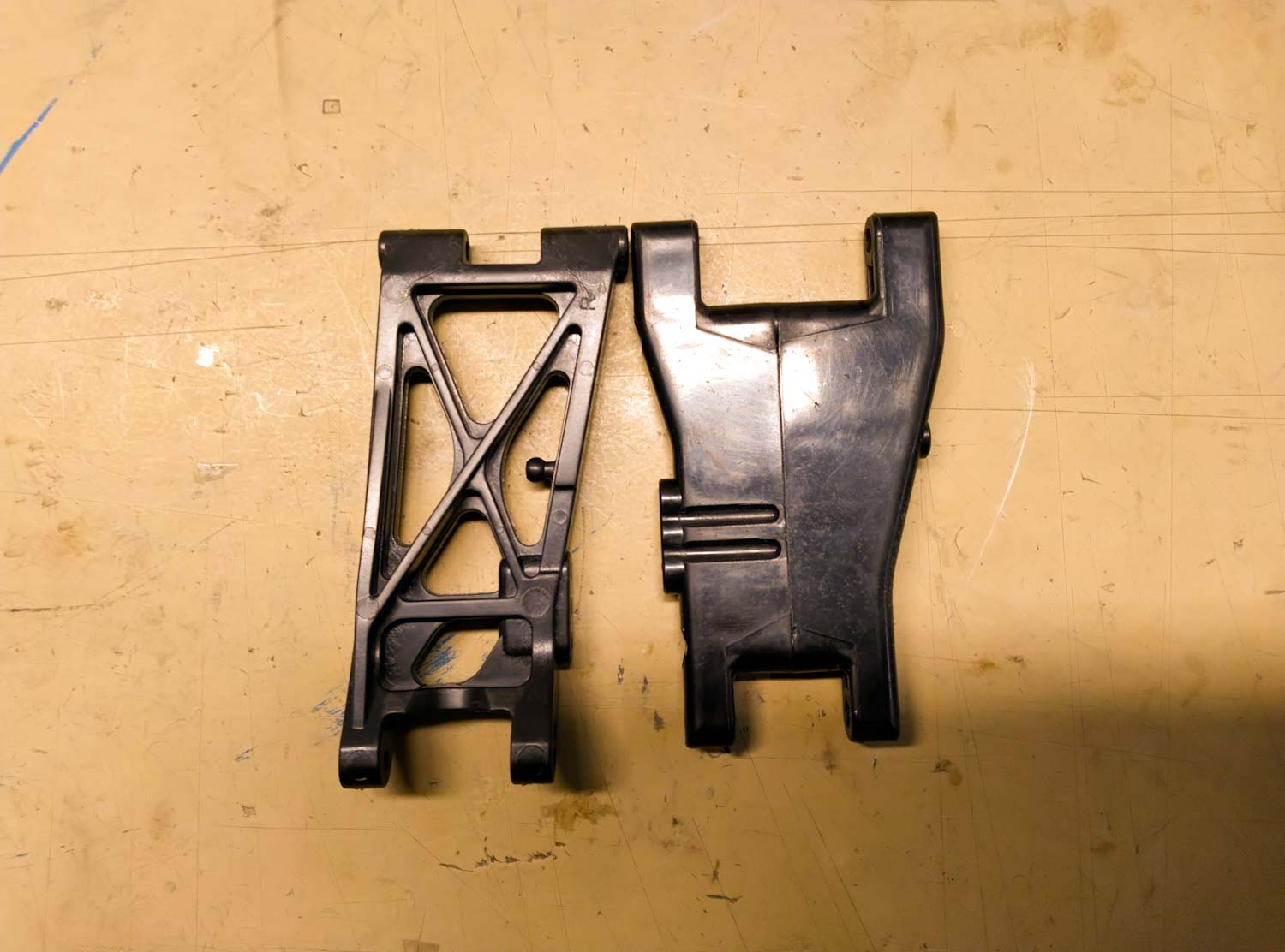

Have ordered the DB01 rear and front wishbone.
As you can see, the DB01 and the DF01 wishbones have identical dimensions. The different dimensions at the gearbox doesn't matter. With the conversion of the rear attachment points I need the smaller width.
The TF has the Dampers in the back so there will be no attachment points at the DB01 wishbones. After some investigations ( i looked at my Zahhak/DN01 😁) I found out the DB02 and DN01 has the same wishbones except they have attachmentpoints in the front and the back.
With the new wishbones you can use the old DF01 or the new DB02 knuckle. I think I use the new one ,but have to test the fitment of the TF driveshafts
In the front things look a bit different. The DB01 wishbone is much longer, but I don't know if the overall length is the same as with the original suspension.
Here I don't know what I want. Stay with the oldschool suspension or switch over to the new one of the DB01.
I don't know if I destroy the "spirit" of the original TF
What do you think?
I say go for it. I have done the same transplant on my Thunder Dragon, and it's fantastic. Definitely not a trad feel any more, but it also does not feel anything like as capable as my DB01 either. It just works nicely.
The big plus for the Top Force in doing the fronts is that you will add caster with the DB01 front blocks. This really improves the steering.

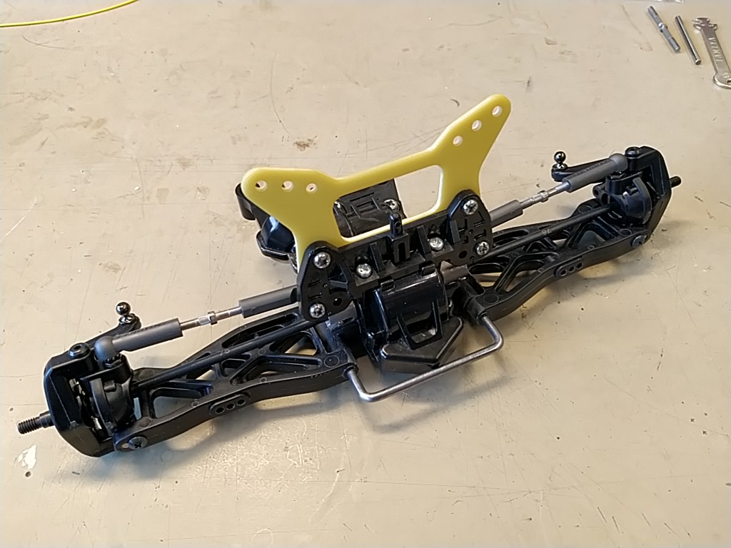

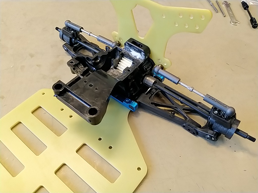

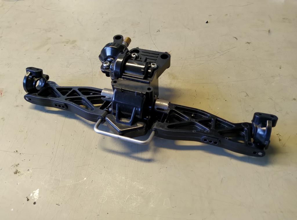

So last week I had some spare time to mill out the reworked lower chassis plate.
Here yo can see my mock-up gearbox and the 2 mounts for the suspension. At the back I also constructed a stiffening for the chassis plate. As the chassis is only mounted on 2 points on the underside, I felt the now longer back need some more stiffness.
The first mounting of the DB01 parts.
It's really interesting to see, how similar are the suspensions of the DF01 and the DB01. Later I will change the tunbuckles , but at the moment the old ones  do their job.
When I receive my ball bearings I will test fit the original TF universal shafts. This will keep the costs down and I have a new set of these :D
I also want to keep the conversion more attractive for others to do the same.

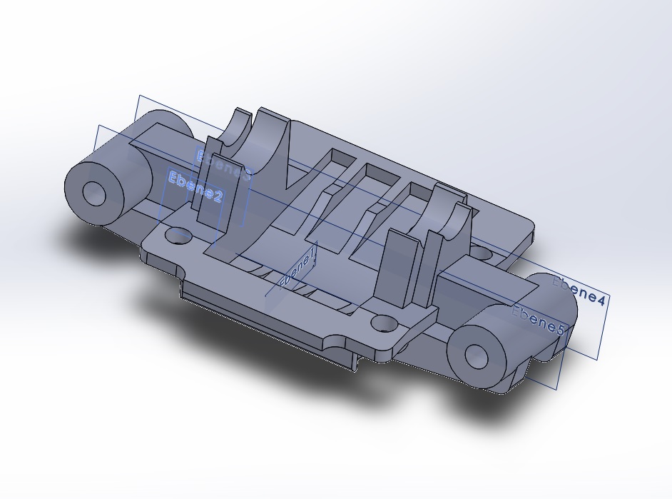

For the conversion we have to cut down the old suspension points at the gear case.
So I fired up the CAD and constructed this...
With this jig, I can mill down the suspension points and a small portion of the gear case cover ( for clearing the suspension mounts).  I use a milling machine, but you also could use a dremel or something.
Next will be some test fitting, and measuring of the damper and turnbuckle length.

Had modified the front wishbones a bit, so they can be mounted on the gear case. Nothing fancy. It can be done with a file, but I opted for the mill.
I really like how it looks and fit. :wub:
I also test fitted the TF universal shafts, but these are to long in the back and to short in the front.

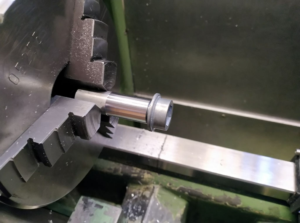

As you know I've ordered the TRF501X CVD. After assembly an test fitting the CVD I ran into some problems. In the front the CVD were about 5mm to long.
The perfekt length isn't available so what to do. At first I thought about shortening the CVD and friction weld the two parts together, but this would be really complicated.
So the second option wins. Let's construct a lower diff cover with wider mounting points for the lower suspension arms :D
Here the new diffcover printed out of carbon fiber filament
Looks a bit rough, but I only need a functional prototype to test everything. Later I print the parts at shapeways etc.
As you can see the wider mounting points also needed a ne U-shape shaft.
In the back the CVD's fit perfect. No binding or anything in the desired travel range of the suspension.
Here with the old case, so no worries about the broken tab.
