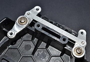

TurnipJF 9192 Posted September 12, 2020 On 9/9/2020 at 4:29 PM, ThunderDragonCy said: But what about the steering arms themselves, the chassis end of the steering? Yes, they fit too. That is what I run in my FF-01. 1 Share this post Link to post Share on other sites
Nicadraus 6198 Posted September 12, 2020 40 minutes ago, TurnipJF said: Yes, they fit too. That is what I run in my FF-01. That's good to know. Mine just arrived and will fit them tomorrow. 1 Share this post Link to post Share on other sites
Nicadraus 6198 Posted September 13, 2020 @ThunderDragonCy Unfortunately the YR steering for TA_02 doesn't come with a bridge. The holes that are supposed to be used for ball connectors for the bridge are too small (about .75mm) and won't fit any screws. I will still have to find a way to make this useful. I'll probably create a bridge from a 2mm carbon fiber. 3 1 Share this post Link to post Share on other sites

TurnipJF 9192 Posted September 14, 2020 23 hours ago, Nicadraus said: @ThunderDragonCy Unfortunately the YR steering for TA_02 doesn't come with a bridge. The holes that are supposed to be used for ball connectors for the bridge are too small (about .75mm) and won't fit any screws. I will still have to find a way to make this useful. I'll probably create a bridge from a 2mm carbon fiber. The crazy thing about that Yeah Racing set is that it is designed to use the stock bent wire bridge. You push it through those tiny holes like you would on the stock plastic parts. In my mind that kinda defeats the purpose of the upgrade, as much of the slop from the stock arrangement comes from the wire bridge and its holes. Share this post Link to post Share on other sites
Nicadraus 6198 Posted September 14, 2020 2 minutes ago, TurnipJF said: The crazy thing about that Yeah Racing set is that it is designed to use the stock bent wire bridge. You push it through those tiny holes like you would on the stock plastic parts. In my mind that kinda defeats the purpose of the upgrade, as much of the slop from the stock arrangement comes from the wire bridge and its holes. True. Plus this one actually doesn't come nor can be fitted with bearings. It has a built-in hard plastic bushing. Share this post Link to post Share on other sites
