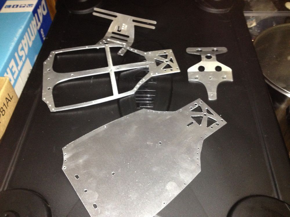

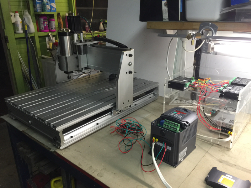

yogi-bear 2299 Posted August 21, 2020 I have a mini cnc/cheap Chinese one, and will not perfect, you'd be able to make chassis plates and a few other pieces. Software wise, I either download a model and process through a program called Cambam, or I do a 2D drawing and then into Cambam. I've only just recently started to learn how to do 3D modelling. On this machine, and cheap 3040 model, with only a 200W motor, I've made these parts. The aluminium is either 0.6 mm or 2 mm plate. Fitted into a Sand Scorcher. but rims would probably take too long to do. I've since upgrade to a slightly bigger machine with a better spindle, (home built controller box) and have made a couple of parts like this bull bar. Its do-able, but rigidity is an issue, so you can get a lot of chatter which translates into roughness. I'm still learning, so I know its possible to get a better finish. This part I draw up in illustrator as a 2D image and then programmed the cut path, not too hard to do. plastics like delrin, which good for swing arms etc, would be very do-able on a mini cnc machine. You'd be able to do carbon fibre as well, but you'll probably wear out cutter bits quickly and make sure you have very good dust suppression or extraction. plus if you are keen, you can machine out bodies out of wood, but a lot of work: I personally at the moment want to do rims and adapters, and the lathe is much better suited. They are more rigid and can cut faster. 6 Share this post Link to post Share on other sites

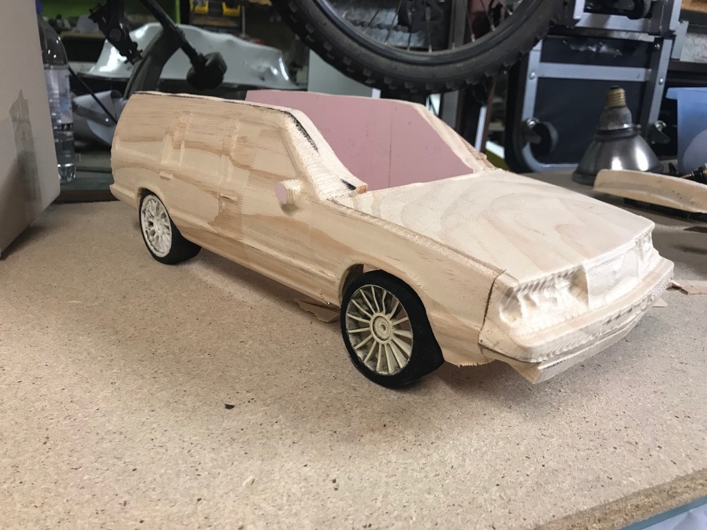

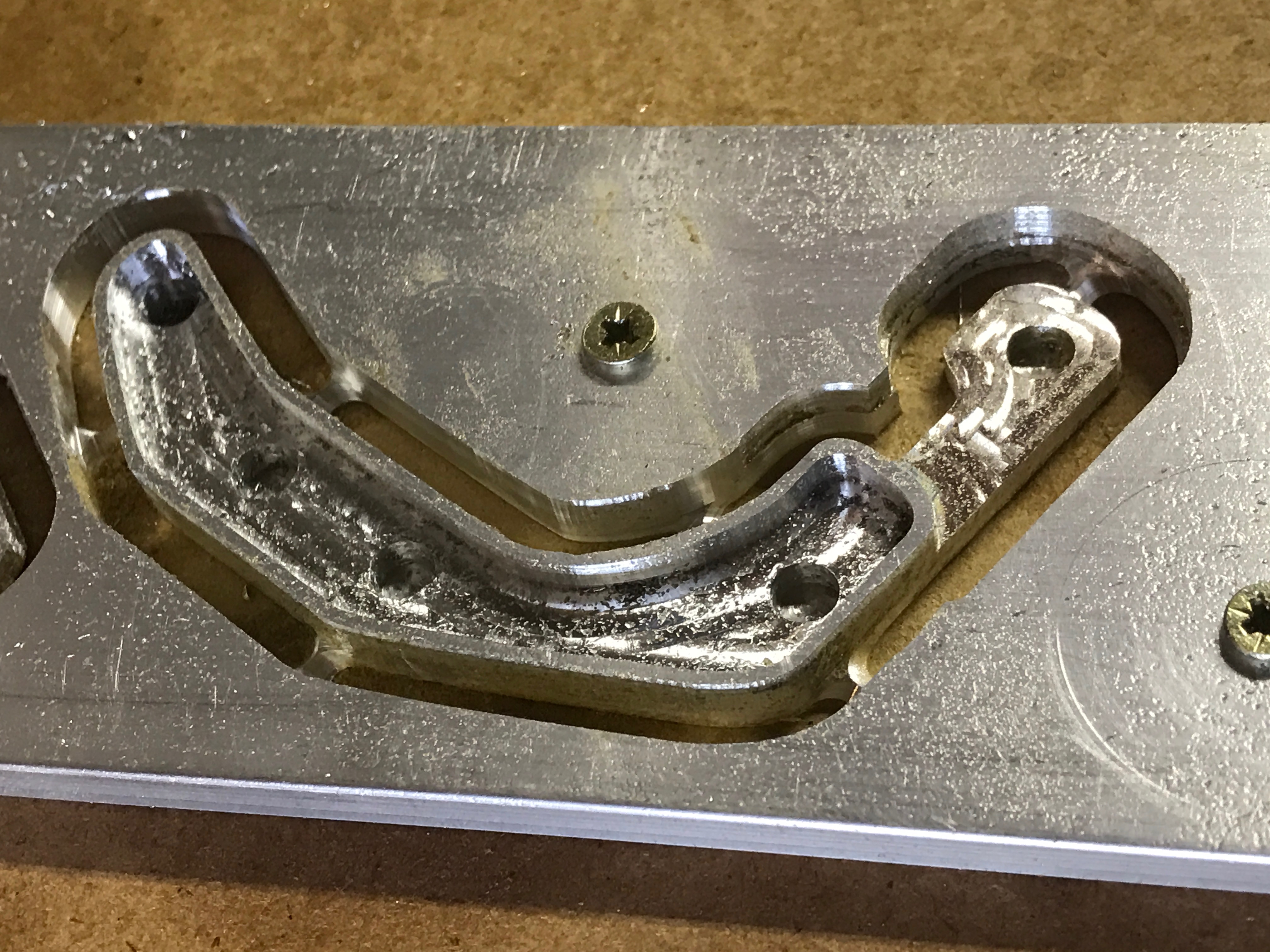

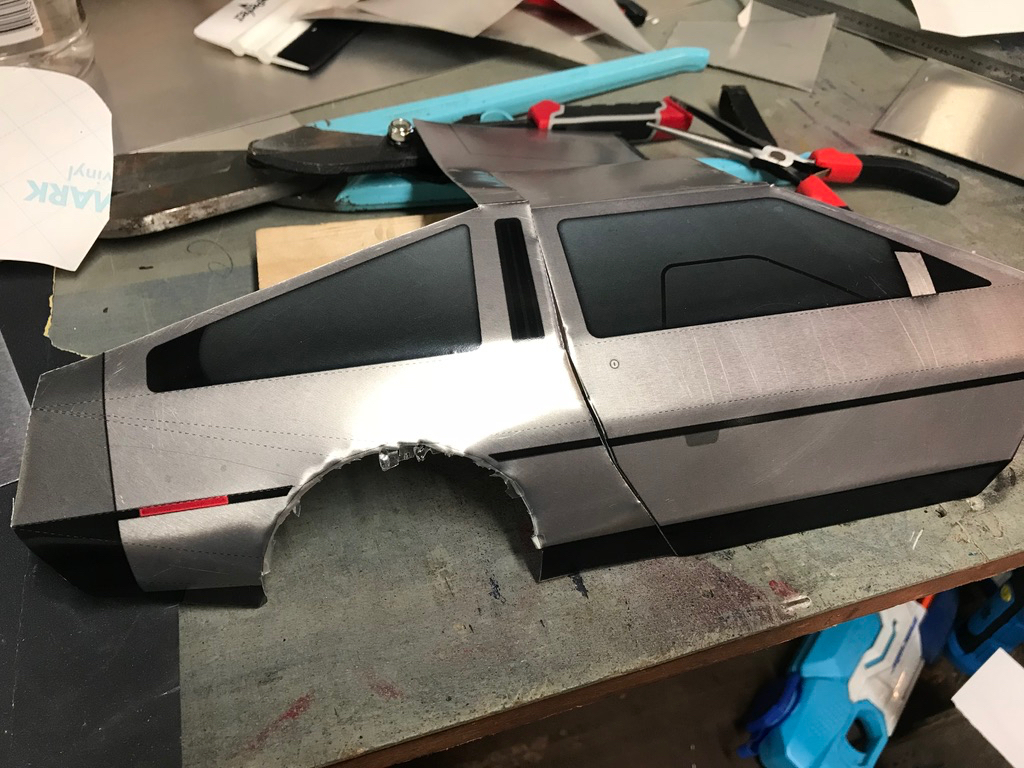

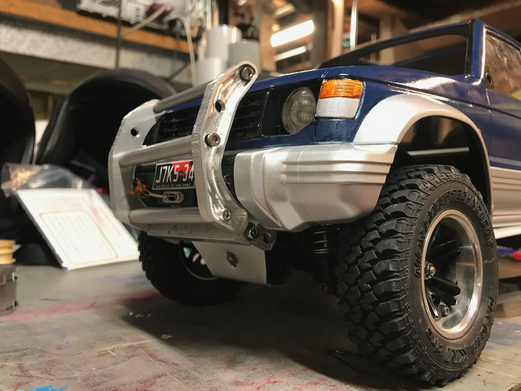

yogi-bear 2299 Posted August 21, 2020 I like this thread! I too am now more into the part making rather than the driving. One of the reasons I got into RC was I realised I was never going to restore a car or build a kit car. Not enough space or money I'm hovering around step 3 too, my main hold up is finding the time to make anything. I managed to machine a set of rims for my Landfreeder a couple of weeks ago and there would have been 6 to 8 hrs all up. I think as I do more, I'll get quicker though. And as well as machining, I also had a go at folding 0.6 mm aluminium metal to make panels and chassis plates. This is an attempt for a Ford Escort plate, the buck for it I machined on the cnc machine. And a hand folded aluminium folded Delorean body I'd started. I use a print onto clear vinyl to add the details. I've since learn how to get crisper edges and will have another go one day! 7 Share this post Link to post Share on other sites
