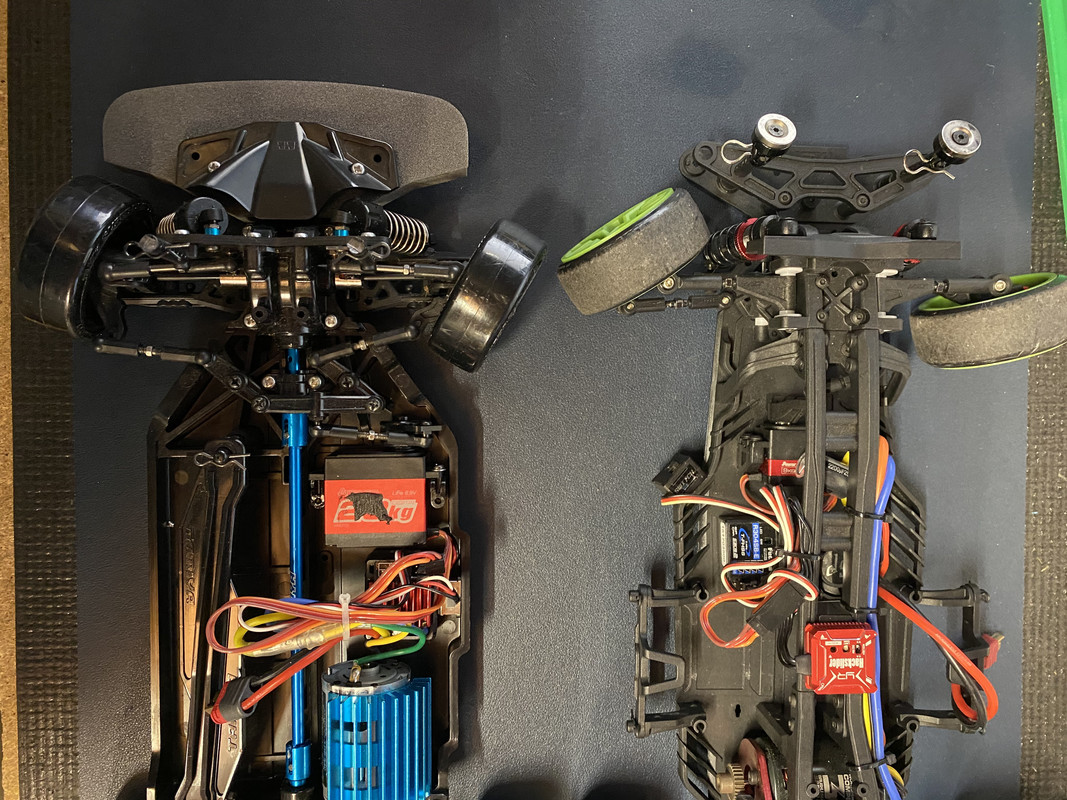

So I have a TT01e and a TT02... I'm thinking of converting either one to a drifter just to play in and out of our house... not interested in competing whatsoever, but I have always wanted to hone my drifting skills and I can only do that if I have a car setup for proper drifting... having a plastic drifting wheel is just not enough...
I dont really run both TT chassis so I'm also thinking of selling one or both to make up for the cost...
What do you recommend... just sell both and get a proper drift car... or sell one (which one?), and convert the remaining one to a drifter?
If I am to get a drift car, which one would it be? If I am to convert, what do I need?

Ahh... surface... it'll be mostly asphalt. I saw a tt02 drift conversion but I'm not sure if it will give me enough to actually find the experience I'm looking for. Plus for its price, it might be better to sell the TT cars and buy a proper drifter kit. This will mostly be just for my occasional use as I learn the fundamental skill... tuning and bling is not the priority as of the moment. In fact, getting into drifting is not even necessary but a want...
I have more reading to do and watching youtube to learn.

I do have a drift spec tire on my tt02. I can drift sideways but I dont have much steering angle and loses control when I try to di figure 8s. I cant connect my turns...

I guess it's the skill that really lacks... my tt02 is stick except for the shaft and bearings... I havent ran a 2s lipo in it... maybe it needs more juice to spin the wheels... or maybe I'm just not steering it right... I think I'm doing too much counter steer and the rear snaps too much... I have to learn how to feather my throttle.
