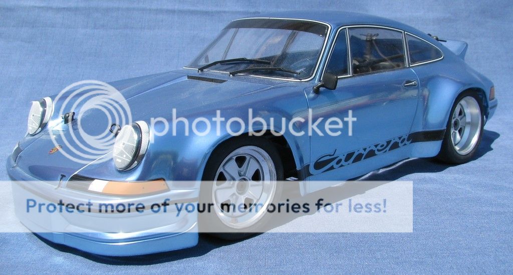

Yup, normal. Used a whole can on my 911 RSR then backed with bright gun metal and white

I’m very happy with how metallic it is! And those photos on a nice but not really sunny evening. I think the bright gun metal plays a big part. Neither black OR white, but somewhere in between! TBH the final white coat was unnecessary and didn’t really make any difference
I experimented on some lexan offcuts before I painted, and straight out of ‘paint’ on a sunny day before stickering  it was crazily metallic

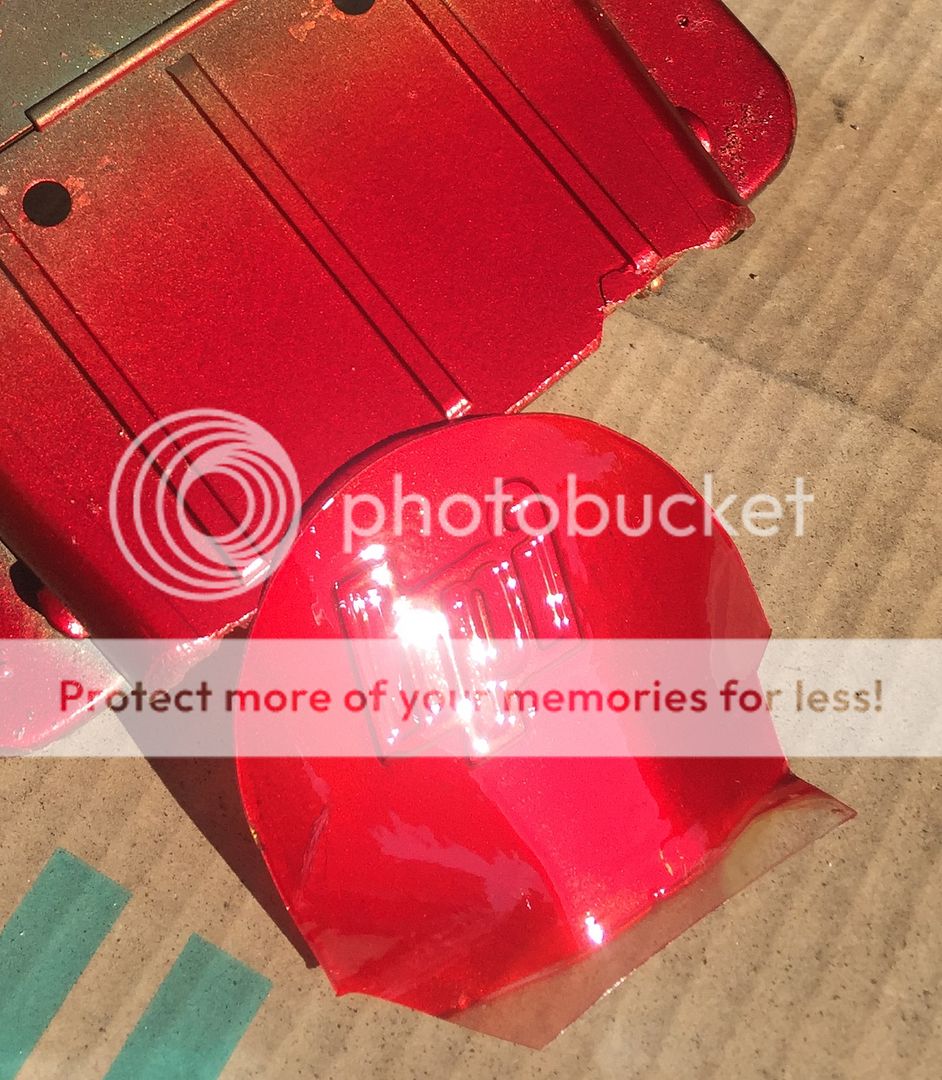

with some colors, you cant tell the final outcome without backing. making paint tests on a lexan scrap piece is the best to do if you want to get an idea, or to know what direction to go (darker/lighter).
You’re right. That’s the best way to test your paint ideas. When I was deciding on a color for my Porsche 934 body I made these test samples. The Wild Willy body substituting for the wing. I painted the gold first then sprayed the clear red.  The wheel well cutout got the red first then backed with gold.
