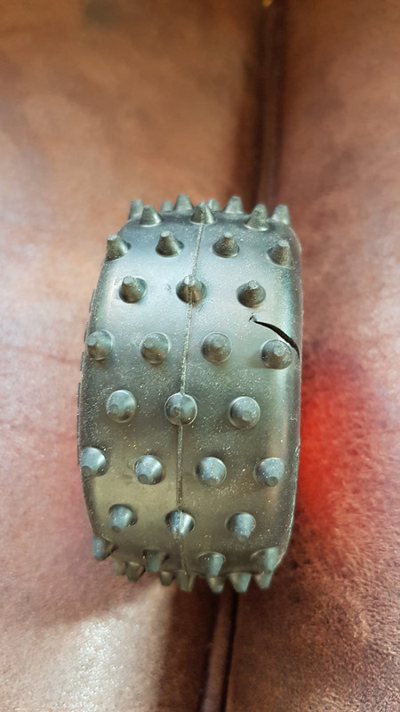

I started inspecting the parts in my Terra Scorcher box this morning. I was lost in that glorious tire smell (one of my favourite things when opening a new kit) when, to my horror and dismay, I noticed this:
This tire was vandalized before it even reached my hands! I have no idea what happened, as that's exactly how it was straight out of the package :(
Total bummer... I wish Tamiya had some customer service, maybe they do but let me guess... "effective Japan only"<_<
My only hope to fix this is that it's a clean cut, at least. If I push the sides together they close up perfectly, so I want to try to glue it together. I'm thinking about what to use, I believe there's specific products for this purpose but can't remember right now, numbed by the disappointment as I feel :P
Any suggestions on the matter? Does tire cement exist? :ph34r:

Retailer as first port of call might be able to get you some replacements?
Otherwise super glue. Have done this before on tires that have split when trying to detach them from old glued rims.
Not ideal though on a box fresh build

@TurnipJF I too am thinking Superglue as last resort, it's just that I'm quite sure there is something a little better for the purpose though I can't remember what 🤔
Cyanoacrylate (superglue) does have a great bond but it's not flexible. While undoubtedly good for glueing tire to rim, it might be a limitation when glueing rubber to rubber because of its stiffness: I'm afraid I'd end up having a hard scar tissue where the cut is, causing the part of the tire around it to brittle in the long run.
But this is what I'm going to find out if I can't come up with something else soon, maybe the more liquid superglue (non-gap filling) will be less invasive.. but I'll try to wait a little, in case somebody comes up with a better solution.

I've used shoogoo countless times on thundershot projects which arrived with tires badly split, doesn't look pretty but is ideal for a runner
So this is a thing?? :blink: or you mean used ones? 😅
Shoe goo is a good idea, but yeah it would probably look a bit messy on a brand new built car. Maybe if I apply it from the inside without too much bleed through the split it won't be too much of an eye sore.
I'm still trying to remember what else is out there. I think that a couple years ago at a hardware store I was given a new type of superglue that claimed to be flexy and good for rubber-to-rubber application, but that was in Europe and I can't even remember the brand so not much help so far... I'll have to research.

It would be bad enough if it was vandalised but looking closely at that crack (zoomed in), not sure if it is just me thinking this but it has jagged edges and looks like a stress fracture/tear? How that happened I have no idea but it doesn't look like a clean straight line from a knife cut? possibly a manufacturing fault or tyre was ripped removing from mould?
What about the glue you get for repairing bike inner tubes? Possibly even put a small patch on the inside of a cut up piece of inner tube.
Superglue for tires is your friend. I´d glue some tape on the outside and apply from the inside. You will hardly notice in the end. But maybe first try to get a replacement from Tamiya. Asking rcmart maybe, that doesn´t cost anything.

After some research, I agree with @Lee76: vulcanised glue seems to be the best way to go. Tough bond, but flexible, which I think is just what I need for effective repair.

Rubber cement seems readily available in hardware stores around here, I'll have a look in the next days. This could also be a good solution, I believe it's got more of a welding action kinda like plastic cement
