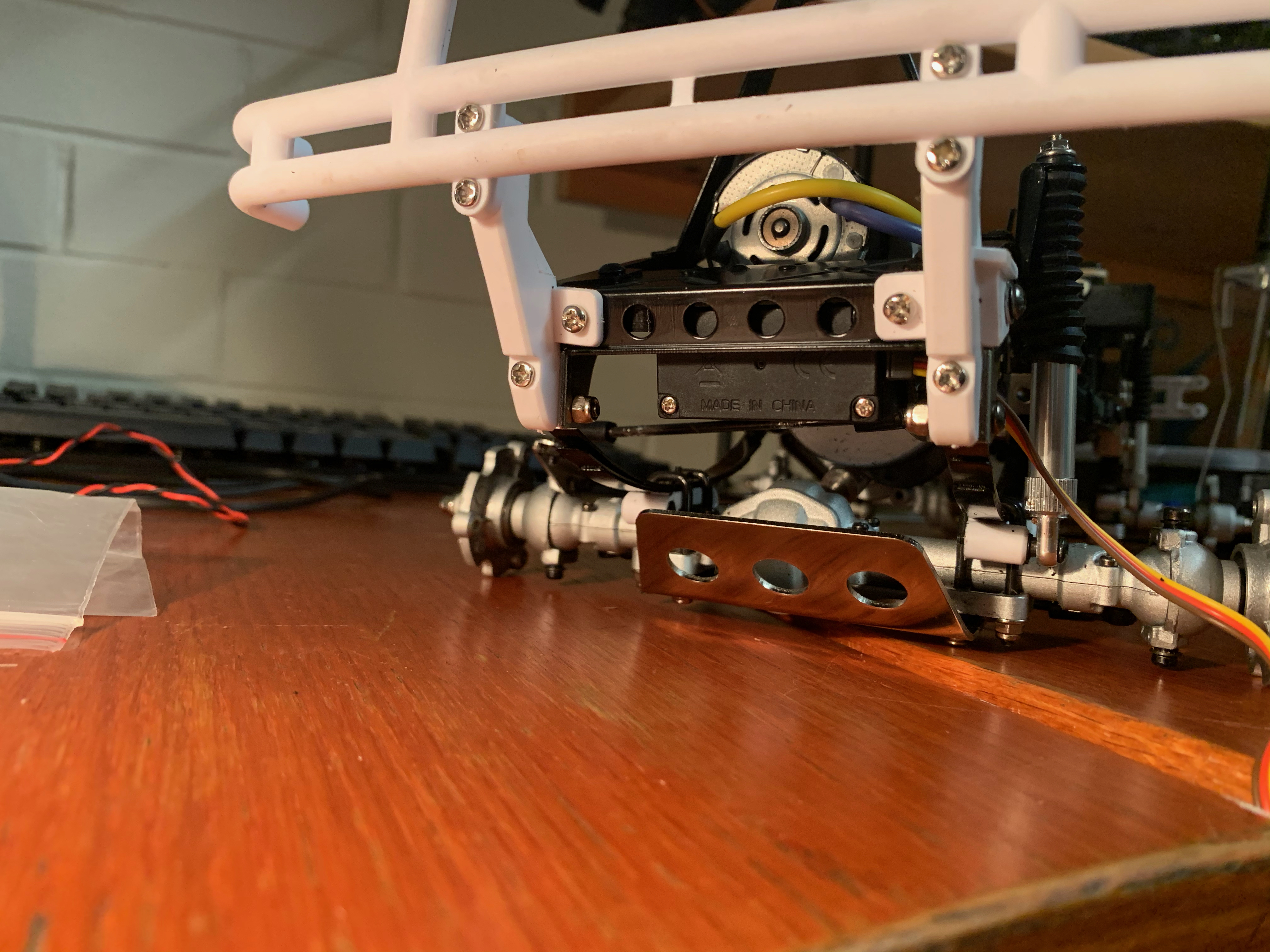

I bought the rtr version of this, and like you wanted a Bruiser but can't justify the cost. The first upgrade I did was to move the steering servo to the very front. The standard setup on both the clone and the Bruiser is pretty rubbish and has a lot of slop. Its an easy mod too.
I upgraded to the steering same servo you've chosen too.
The only other mod I've done is to 3D print wheel adapters to convert to hexes.

ended up with this
steering upgrade
better rims/tires

Not sure I can do the steering servo. the body I want to mount on this chassis has a mount that goes right near where the steering servo would be located to. I will need to wait and see.  Originally I was going to use a Clodbuster body but I am thinking once the truck chassis is built I might do the RC4wd Blazer body
something like this:
that Blazer body would look pretty cool. Set it up as stock and see how it goes, but I think you'll want to upgrade the steering somehow as the original setup is truely awful. You could probably do the steering another way if the mount is in the way.
If you can find the Hot Racing aluminum steering upgrade along with the metal gear high torque servo, it will tighten up the steering much more. It will not be as tight as moving the servo up front, but it will be much better than stock.
Just ordered the Steering kit from RCMart along with a Hobbywing 1060 ESC, since I have read good things about it. Now to decide on shocks..
