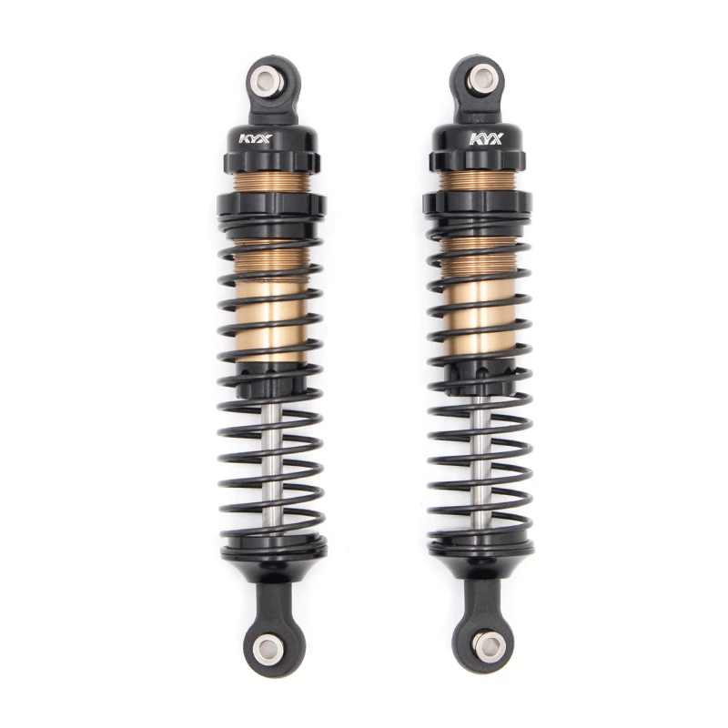

Nicadraus 6201 Posted April 20, 2021 For buggies or crawlers, I highly recommend this... KYX. They come in 80-100mm. I've tried several shocks for my CFX and this is the best and have no plans of changing again. 1 1 Share this post Link to post Share on other sites

Bwaaatch 528 Posted May 1, 2021 On 4/20/2021 at 3:36 PM, Nicadraus said: For buggies or crawlers, I highly recommend this... KYX. They come in 80-100mm. I've tried several shocks for my CFX and this is the best and have no plans of changing again @Nicadraus, I'm interested in these gold KYX shocks, having a strong recommendation like that means a lot. But I need them at 80mm. Struggling to find them online (always 90 or 100). Are you sure there is an 80mm version, or can they be built shorter somehow? Any chance of a link? Gotta be gold, though! Cheers! 1 Share this post Link to post Share on other sites
Cynan 520 Posted May 1, 2021 You can use black o rings under the piston head inside the shock to limit the travel to make them shorter. Depending on your use case you may need weaker springs after though. 1 1 Share this post Link to post Share on other sites
Nicadraus 6201 Posted May 2, 2021 3 hours ago, Bwaaatch said: @Nicadraus, I'm interested in these gold KYX shocks, having a strong recommendation like that means a lot. But I need them at 80mm. Struggling to find them online (always 90 or 100). Are you sure there is an 80mm version, or can they be built shorter somehow? Any chance of a link? Gotta be gold, though! Cheers! All the 80mm are available in red. I'm using the gold but used an extension on my shock tower to accommodate. 3 hours ago, Cynan said: You can use black o rings under the piston head inside the shock to limit the travel to make them shorter. Depending on your use case you may need weaker springs after though. @Bwaaatch this ^. I've also done this method to a friend's shocks and to my Wild One when I upgraded the shocks. Just make sure that the o-rings you use is smaller in diameter than the piston so it won't block oil flow inside the damper. 1 Share this post Link to post Share on other sites
