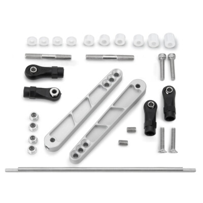

Maybe i could fit a Sway Bar of an Axial?
Sadly i do not have the Dimensions of that, something like that would easily fit via ZipTies:
https://www.ebay.de/itm/Alloy-Rear-Anti ... SwpKtdQpbo
Does anyone has the Dimensions of that Axial Buggy/Truck?
The dimension of the Aluminum Part is 73,5 mm
Maybe someone is Able to measure the Rod. I'm only able to use Paint, so i have no measuretool.
Also i'm not Confident that the Ends of the Rod do not snap. The halfed rod seem not to be very tough....

Well fudge it, i`ve just ordered 2 Sets of that:
I want to install it either on the Outside of the Letterbars, or on the Inside if the Rod is to short or i will install it on top of the Letterbars with ZipTies or even maybe i´ll turn it around and install it into the chassis witch the poity ends showingt to the back and the front of the Truck (like on better Chassis)
If the Rod (i think its about 13,5 cm or 6.4" long) is to short, i can get Pianowire and flatten the Ends to screw them on.
If i would know an Metalworker, i would make specific Inserts for the Letterbar that would just fit inside the Cutouts of the Letterbars with the same Screw on method of thesese Axial Swaybars.

but would it be possible for Anyone to take an imprint of the Sides of the leddarbar, so you can machine 2 pieces of aluminum (Like the Pieces 2 Posts above) that mold right into the original Ladderbars?
I want 2 simple pieces that you could mount easily on the Truck without disasambeling it fully.
I should be attachable with these little grubscrews.
In short:
It should be exactly like that thing 2 Posts above, but the 2 black aluminumarms should fit right into the Outsides of the original ladderbars.
