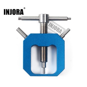

By the way, if the issue is that you have the pinion, but on the wrong motor, you can get pinion pullers (random pic from the internet)
Motor Pinion Gear Puller Remover Repair Model Aircraft Tools for RC  Helicopter | eBay
I have one on my toolbox, not had a problem with getting a pressed pinion back on (just need to make sure you press from the opposite end of the armature).
