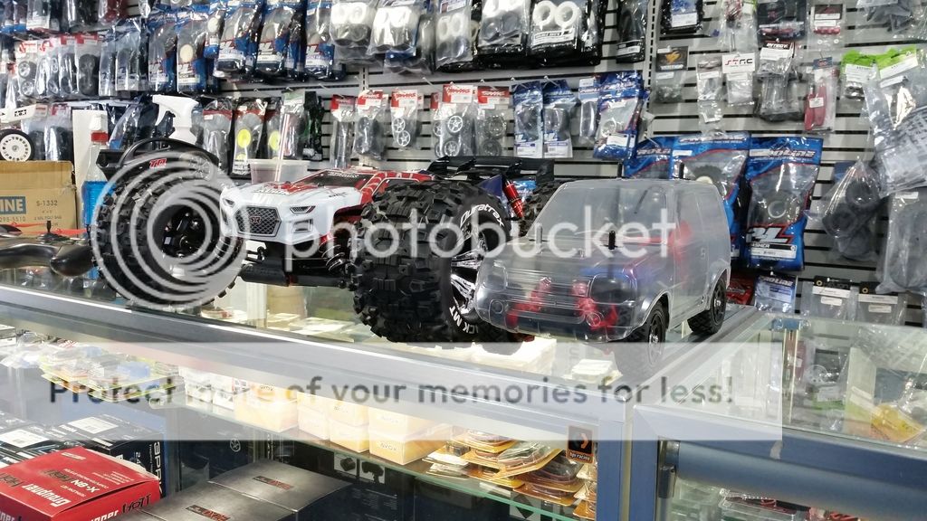

Guess I’ll start my first thread with this one. I bought it in ‘15 when I was still working for a hobby shop but didn’t get it to the point where it was painted and driveable until after I switched to my current customer service call center job in 2017.
And with a then coworker’s ARRMA
I eventually bought the current rolling stock, which required some lift and trimming.
it was at the point it needed paint when I had a change of career and set it aside until that was more stable.

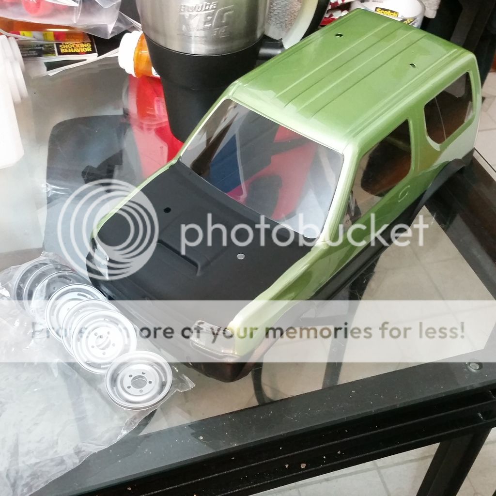

Here what eventually happened, painted the body in a very 70’s Lime Green metallic lacquer from Model Master (works great in lexan!)  with their flat black from the same paint line on the outside for the hood and grill section, and then covered the inside and rocker/flare area in Duplicolor bed liner with their adhesion promoter  to get that to stick to the lexan on the outside, the paint used does that on the inside, so none is needed there. The wheels were shot in Duplicolor’s metal etching primer then color coated in their silver engine enamel, then found out that I should have put a normal primer down over metal etching primer before the color coat.......guess I know better know:rolleyes::lol:
If anybody is wondering where that color scheme comes from......well, considering it’s name and size.........:D
Here’s how it looked done with all but the Aisin locking hub style wheel nuts I had eventually added to it.

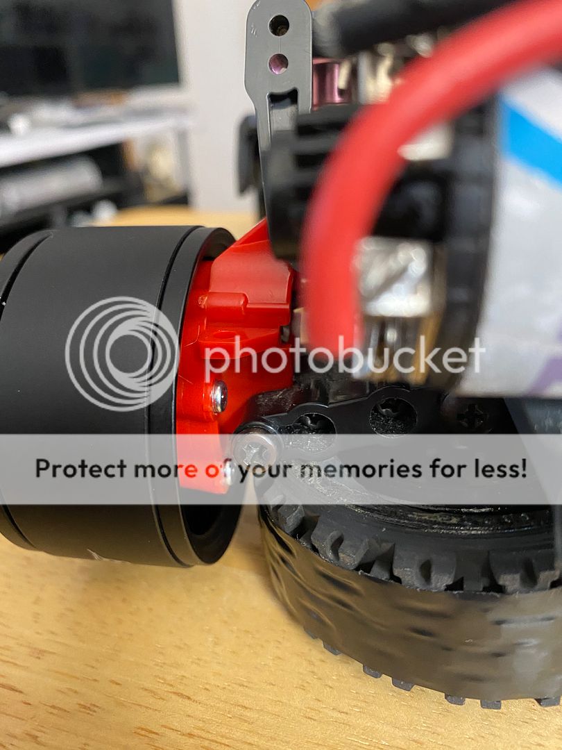

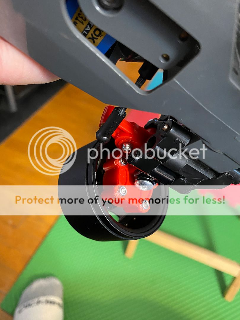

Ran into a small problem when I took a closer look today, the 1.55 wheels drag on then cases and top screws to the point the paint was getting scraped off while driving it once done.
001(235).HEIC
001(234).HEIC
Same up front too
001(234).HEIC
001(233).HEIC
I tried both a set of HPI Vintage NASCAR wheels that I had put the trucks original tires on as well as an old set of Axial 8 hole beadlocks, turns out the HPI’s just clear and the the Axials do Not due to the design for the beadlock ring attachment on the back sides of the wheels.
001(232).HEIC
here’s what the final clearance on the HPI wheels are like
001(237).HEIC
001(236).HEIC
So..... as of right now, it has a slight.....”skipped leg day” look going until I can get new rolling stock.

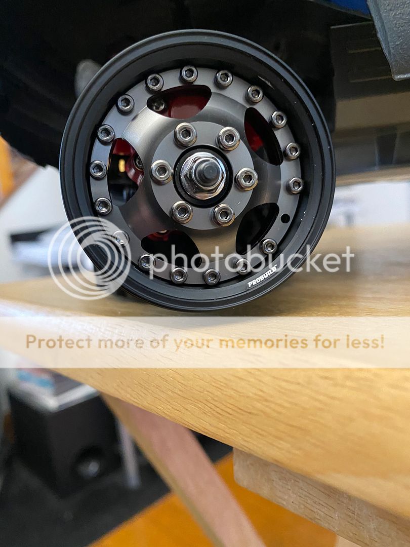

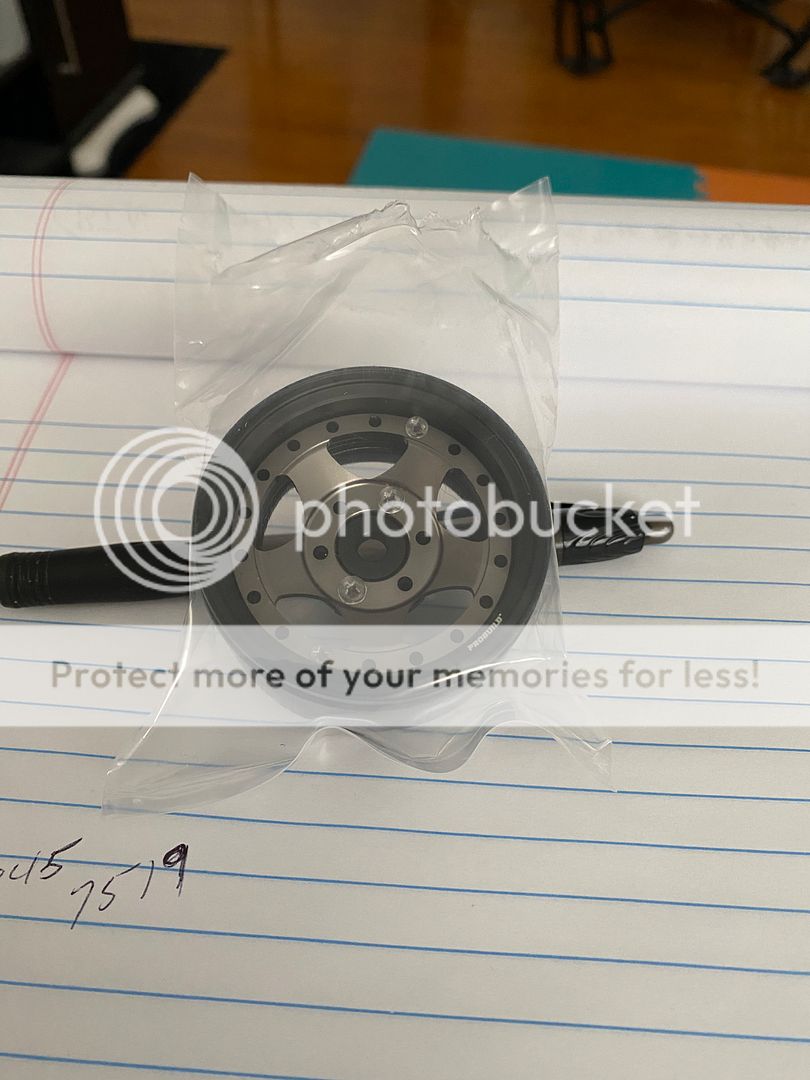

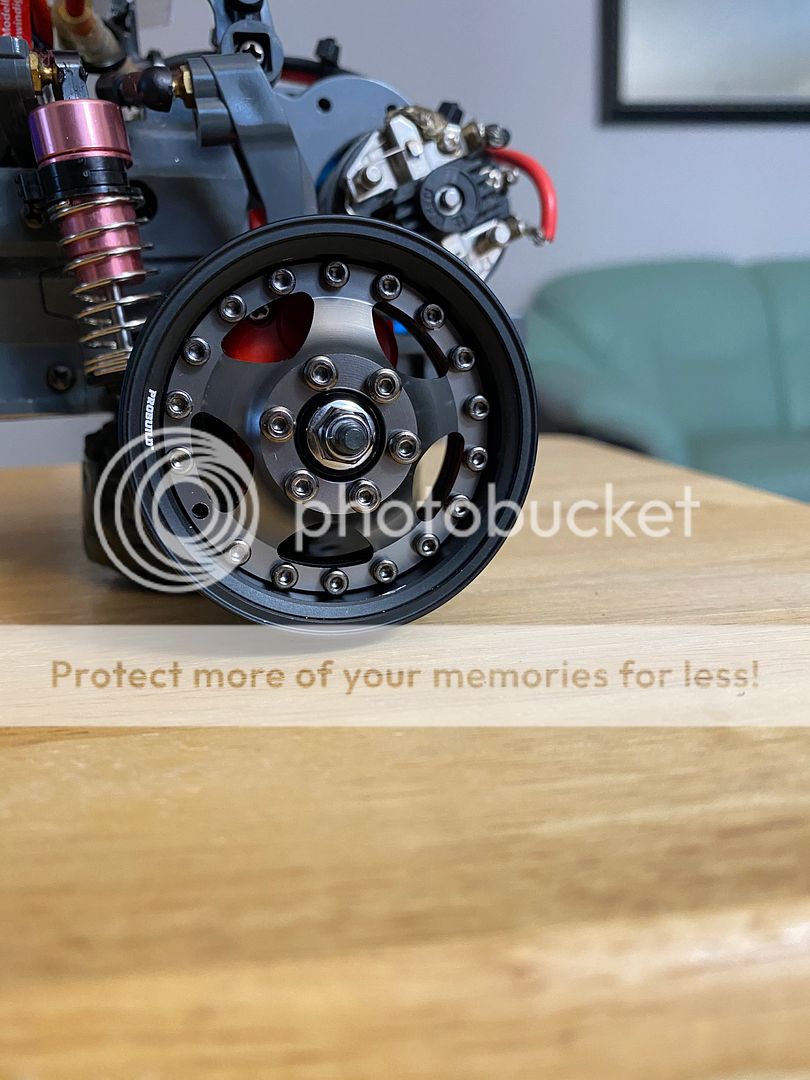

Found that Boom Racing offers 1.9 beadlocks that you can spec out the colors, hardware, and hub depth on that are about the same I.D. as the HPI wheels are. Ordered one to test fit with a 5 spoke gun metal wheel face, matte black barrel, black lock ring and hardware, aluminum lock ring, and 1mm offset hub.
Once I get it and mount it up, I should know how well the wheel clears the gearbox case and order the other three to match and get the tires too!
If these do work, I want to get some for the Dynahead I plan to buy too and with the exception of the bronze 10 slot face, they’d otherwise be identical to what I ordered for the Jimny.
  • 4 weeks later...

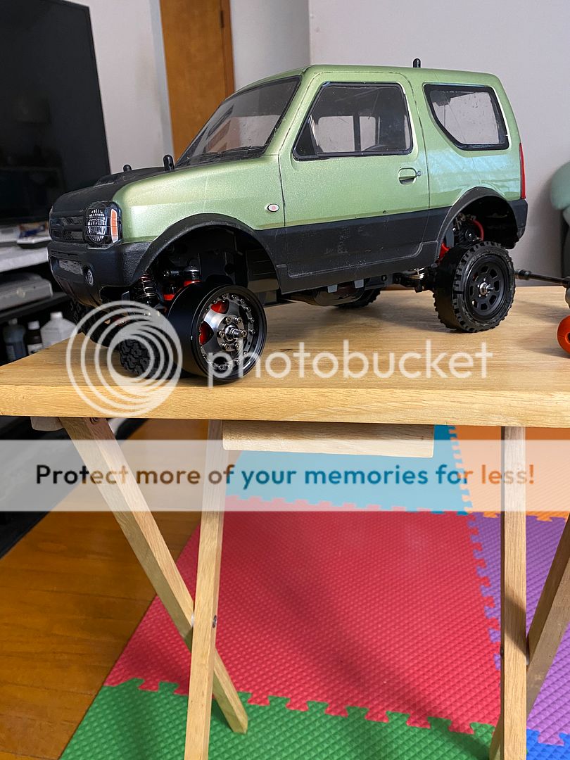

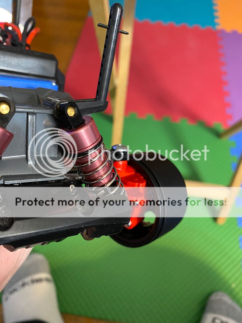

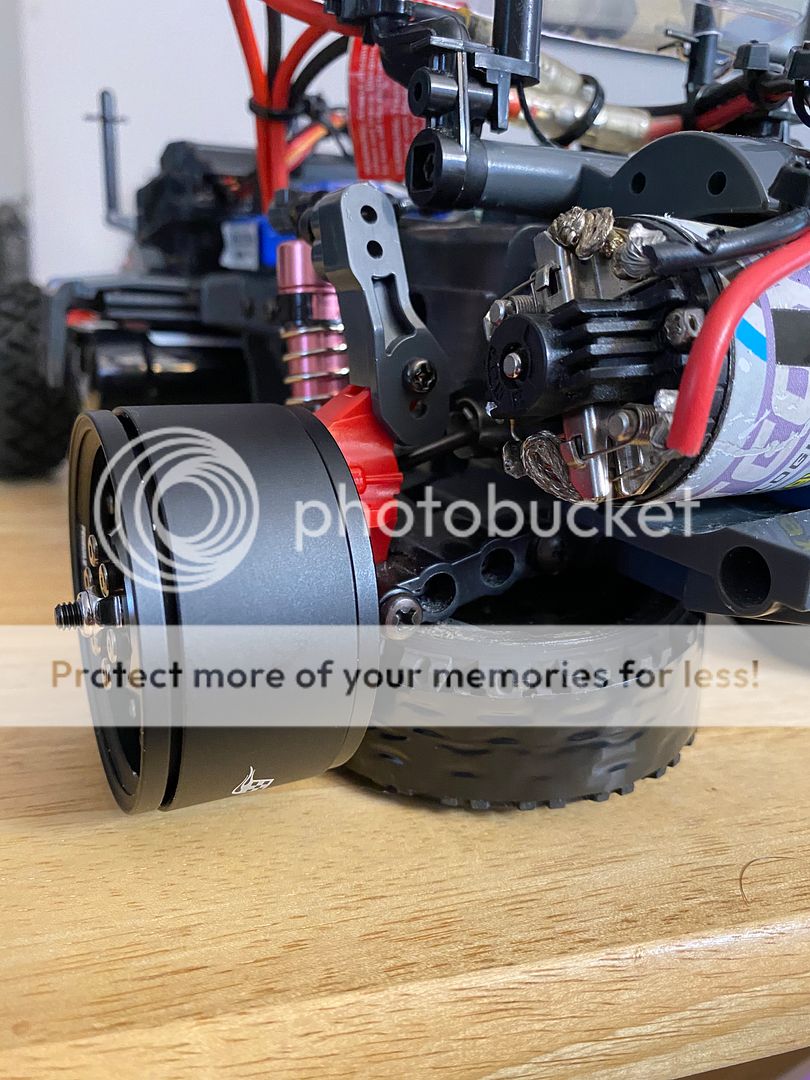

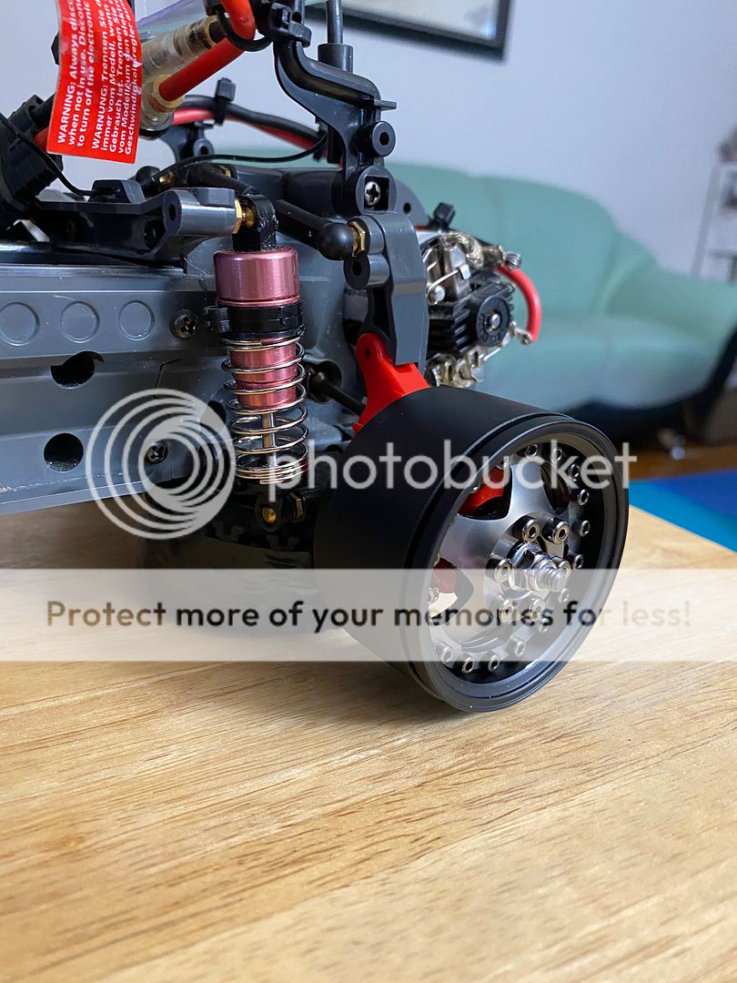

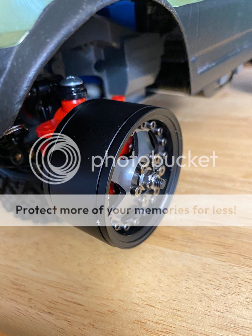

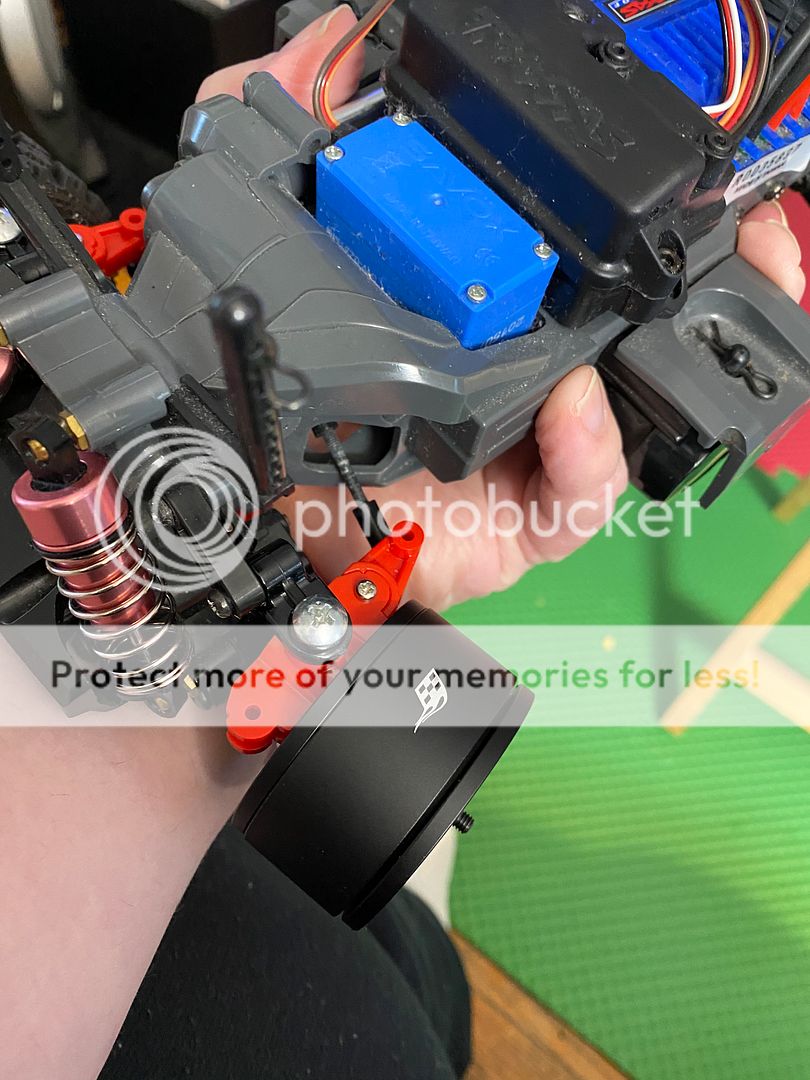

Ok, I finally for the Boom Racing wheel in and it clears these Tamiya portals nicely! There’s plenty of clearance with the wheel face flipped for maximum positive offset with the thinnest hex hub installed and it looks like the tires will stay within the trimmed stock flares too. I’ll get the other 3 wheels and a full set of tires on order soon as I can afford to (just got home a weeklong hospital stay and now will be on a picc line for another 5 weeks that my insurance has already refused to cover).
On to the pics, starting with the wheel!
7938E02D-941D-43B0-8864-957F9687B58A.jpe
Then how it fits the front,
C920A2B8-6F55-4495-824B-82922AB0185C.jpe
D2E4EFA0-FFAB-4A8C-98D9-2182FBE0B59B.jpe
DEAF0400-E9D0-45A7-8B77-6E0A8FEAE489.jpe
8C010011-8619-4E68-97E4-DCBF4395107F.jpe
8EB11C51-F316-436F-9DDF-BDBDCEB08B45.jpe
6A32500D-B590-4E96-AA1E-0551D27881D7.jpe
7AAA9C20-3806-436C-AB90-20E4AAC8F6C5.jpe
6DD0C295-0F68-4F6F-AC1C-0ED1647D5C03.jpe

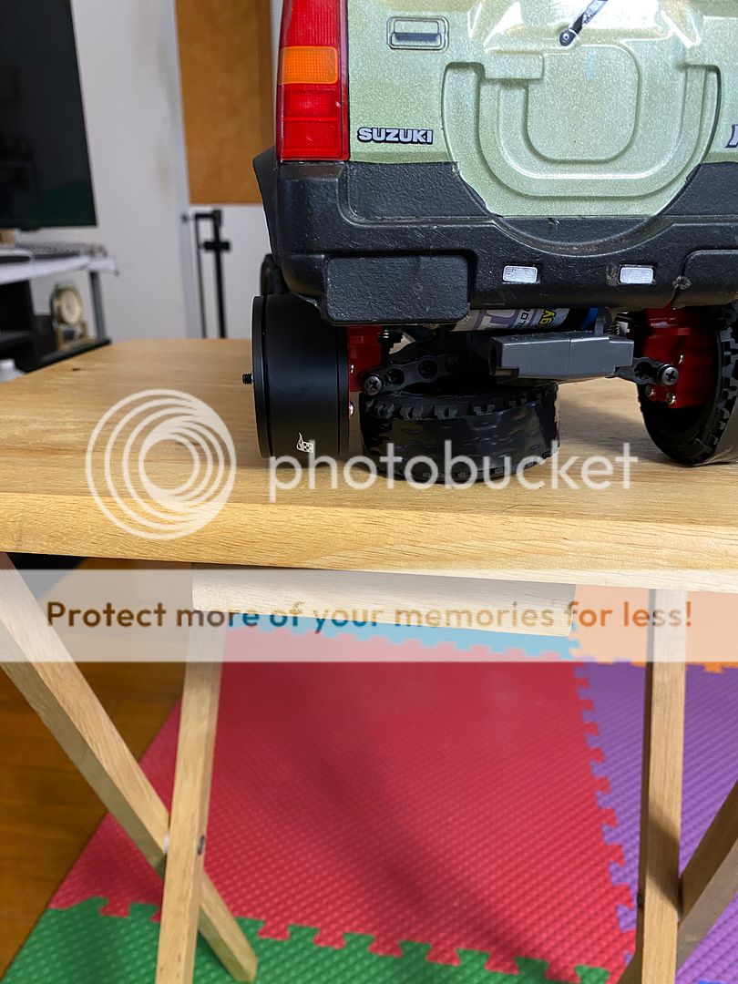

And then on to the rear.
32D73335-E9F7-44C5-B317-E3406519C558.jpe
DB1466D0-7E03-40F4-BDEB-21FA3B220AC8.jpe
922BC3FE-C816-4CB8-97AD-7A041A979427.jpe
539F864D-D947-4EC4-83BA-662B83C8A755.jpe
C3703CEB-7424-4151-A1E6-059FB5CB05CE.jpe
4C8F0934-477F-4FD6-9FF5-0FBF600CC5C5.jpe

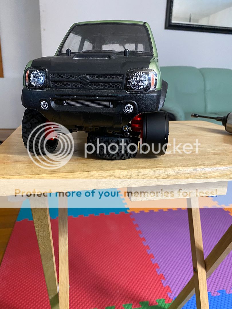

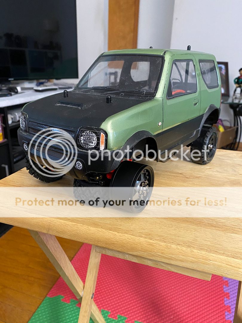

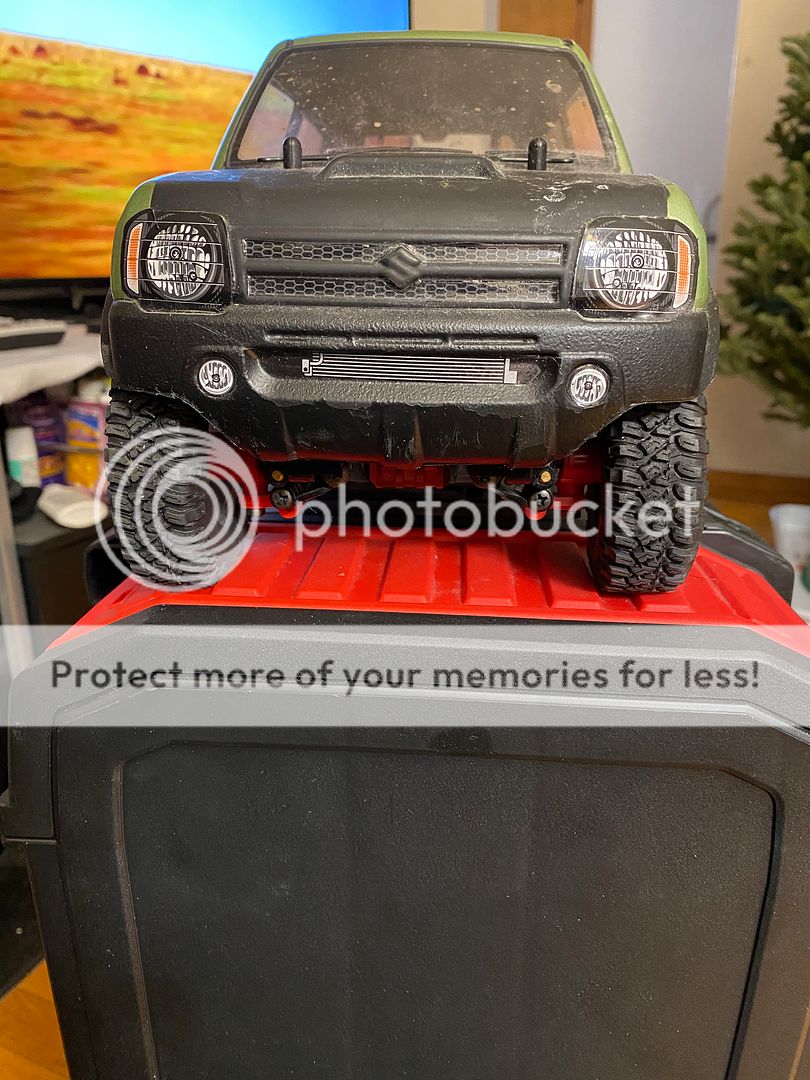

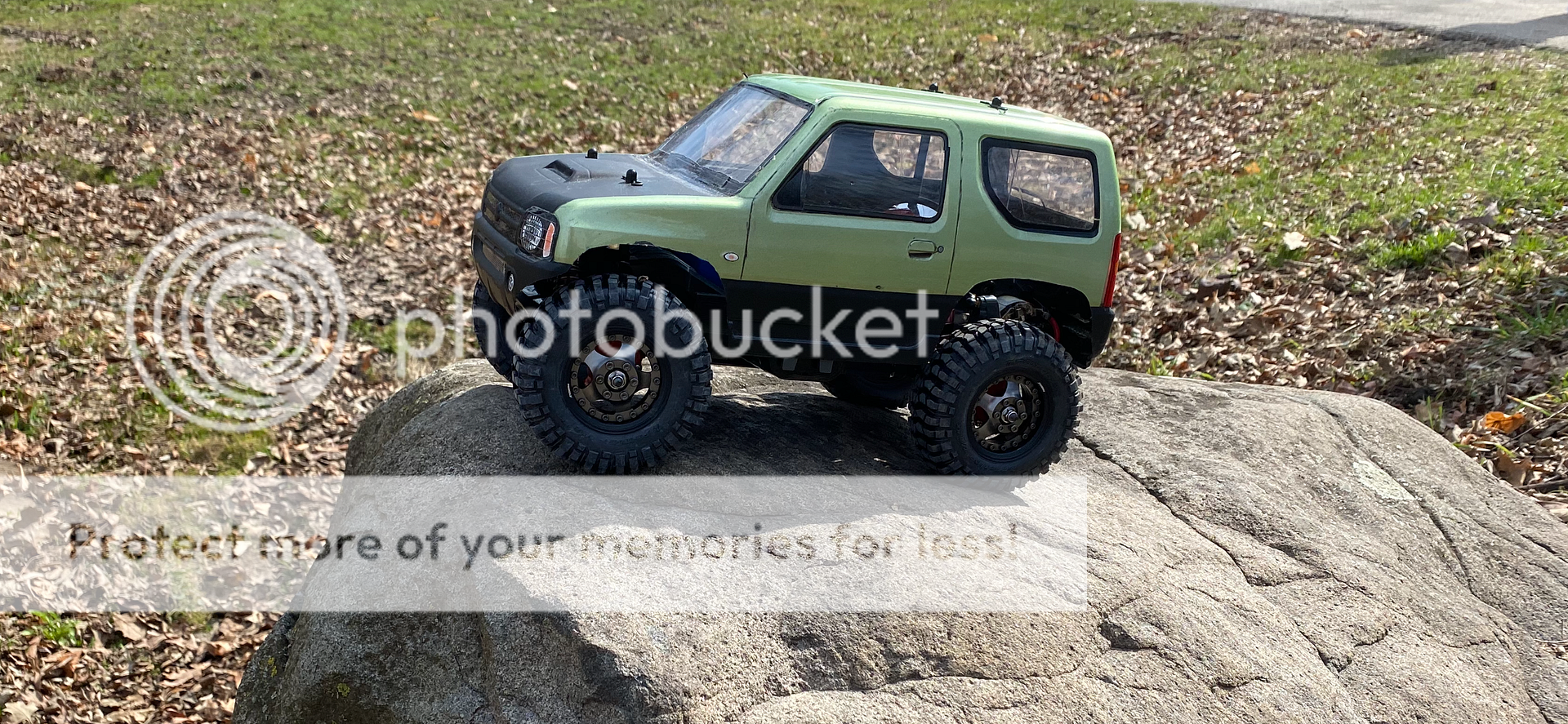

Got the Proline 3.85” BFG Krawlers T/A’s for the Jimny today!
001(251).HEIC
Now I just need to get a set of BFG’s Comp 2 A/S+ for the Chrysler 200 I daily👍😅
Boy that has some ground clearance now. Fitting portals to it was a stroke of genius. I know you can get them by going the VW Trail/Dynahead route but its such a shame they have not released them as a Hopup. I think there are many projects that might be if they were more readily available
The extra clearance is impressive as is the low down power between this and the old Integy 55t I swapped into it. It would be nice if they sold them as hop ups, though not only did I buy the MB Tr to get those, I’m still planning on getting a Wild Willy 2 kit so I can build the rest of the GF-01 into a 4x4 WW2 and use the rest of that as a parts source on the interchangeable bits.........they’ll be getting more out of me that way🤔

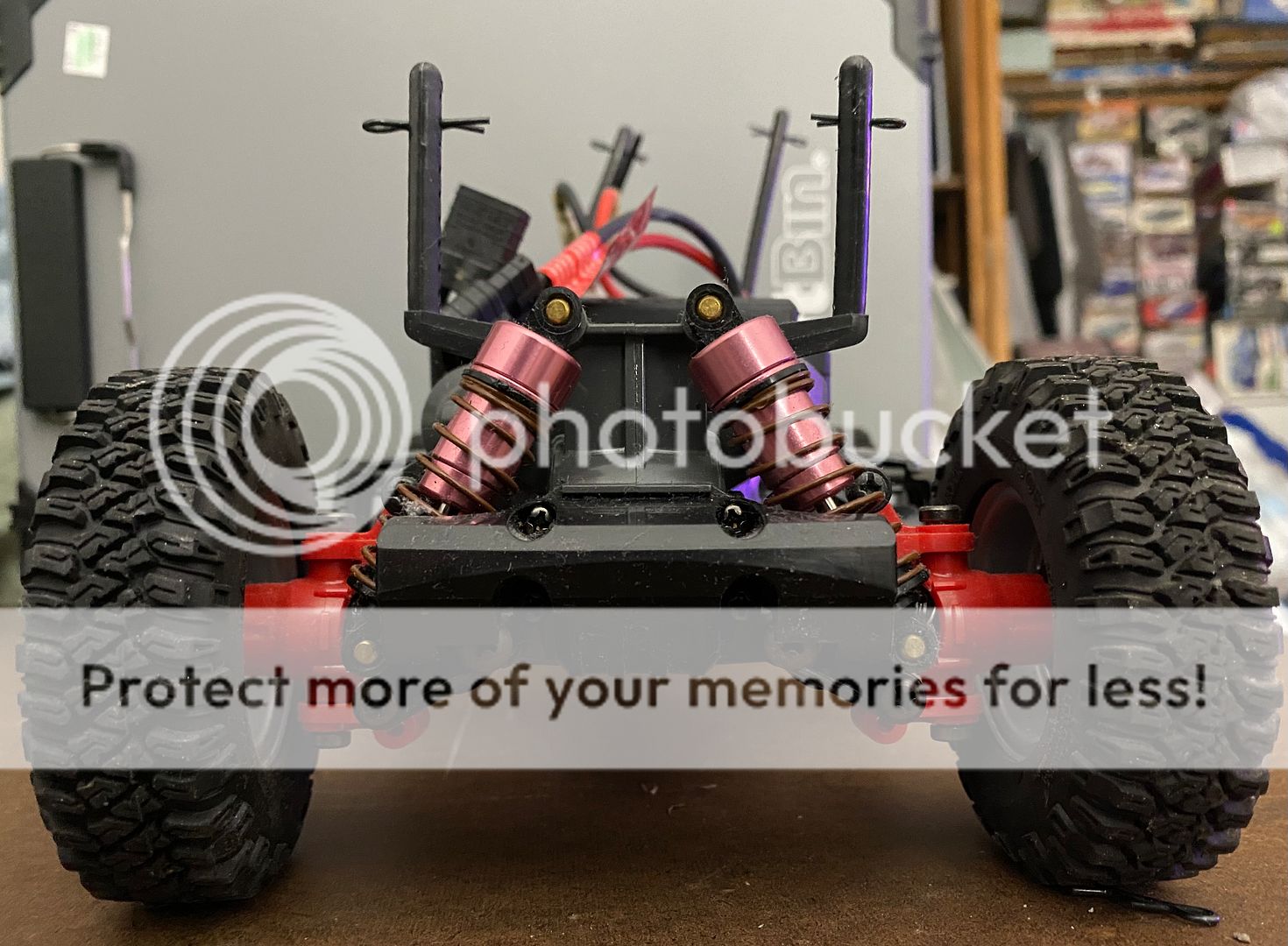

Got the last thing needed to get this little rig where I want it!
Made a trip to the LHS I bought the tires and battery for it at to see if they had any springs that would fit it and found a little package of RC4wd 100mm King Scale Shock Springs pn Z-S1117 that has 4 sets that range from very soft to stiffer than what it already it had on it.
001(292).HEIC
001(301).HEIC
I’d swear that these springs were made for these shocks too, they fit THAT good!
001(300).HEIC
Just the softest springs up front is a huge game changer on this thing!

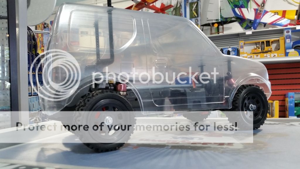

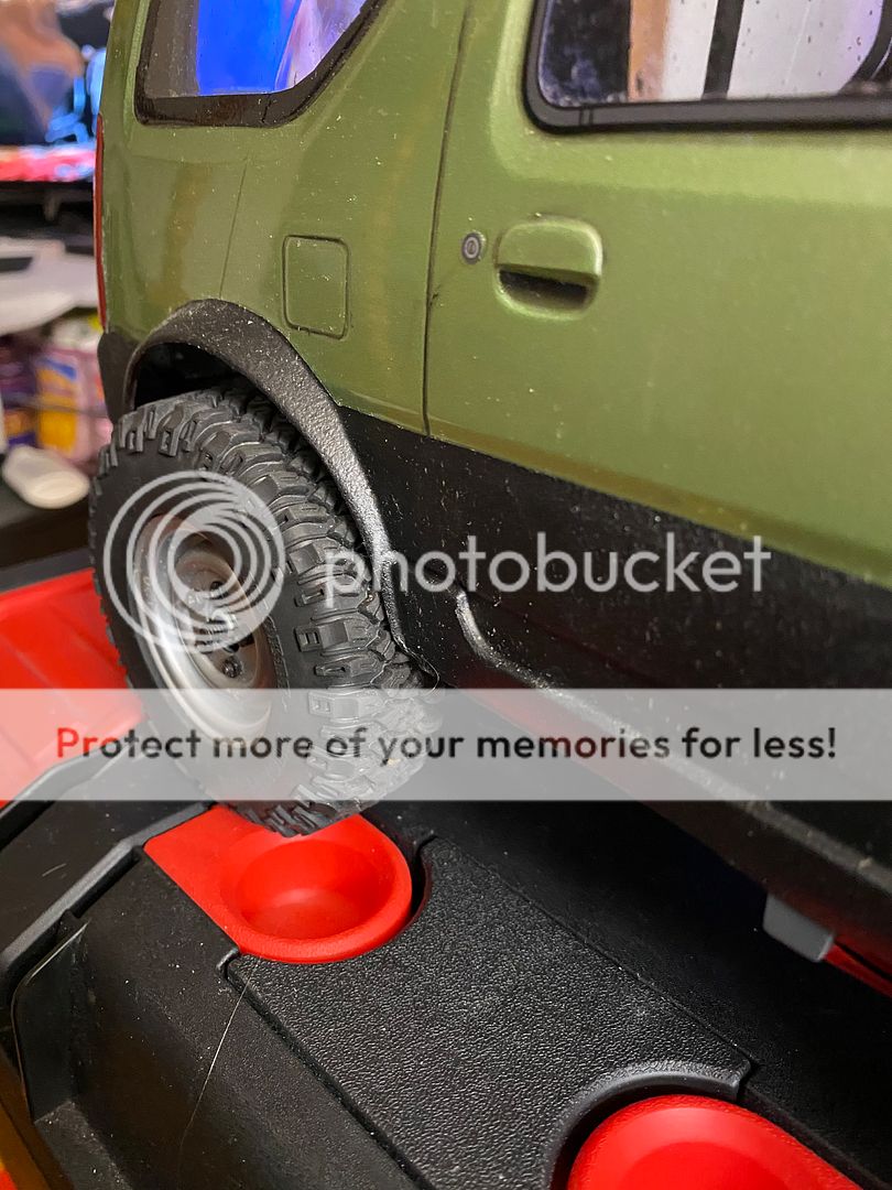

Then with the body back on it.......some trimming is needed for the front opening, the tires grab the back part of the fenders and front bumper.
001(297).HEIC
