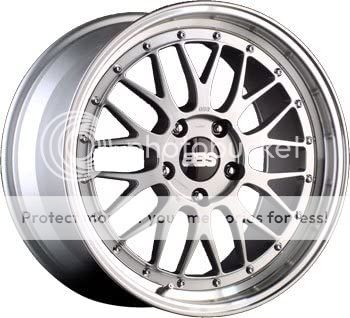

14 hours ago, Shodog said:
Well now I’m not so sure. The rim is supposed to be the BBS LM. You can buy them two different ways
Same rim, deep offset vs shallow offset. The rims on the Porsche are definitely the deeper kind.
Isn't the difference in the above pictures that the centre section is sandwiched between the inner and outer rims on the top image (meaning the lip around the perimeter of the centre is part of the outer rim), and on the bottom image the centre section is on the outside (meaning the lip is now behind the centre section, so the area with the bolts is the same colour as the centre section)? This has the effect of enabling a different offset using the same rim parts.
Deciding how to paint the tamiya rims depends on how the real car had the bbs LM 3-piece wheels made up - with the centre section sandwiched or on the outside. This is, of course, moot, because the 934 used the bbs e50 wheels, and the LMs look too big and new for this old racer (although they look better than the godawful effort that came with the 30th anniversary version)!
In a proper way (read as OEM), the center section is sandwiched between the lip and the internal part of the wheel. So the topic starter made it right and the wheels looks very real and awesome!

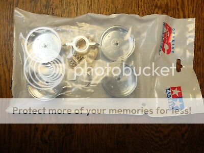

So true, the 30th edition is a much better kit overall, but the wheels are just wrong, the black edition wheels are not perfect, but the 30th wheels are way worse. I wish there was a proper set of wheels somewhere for the 1/10th 934, with the big meaty tires at the rear.
Like these?
9 hours ago, VileQuenouille said:
That looks about right, they don't replicate the 3 pieces aspect of them but the overall size seems okay

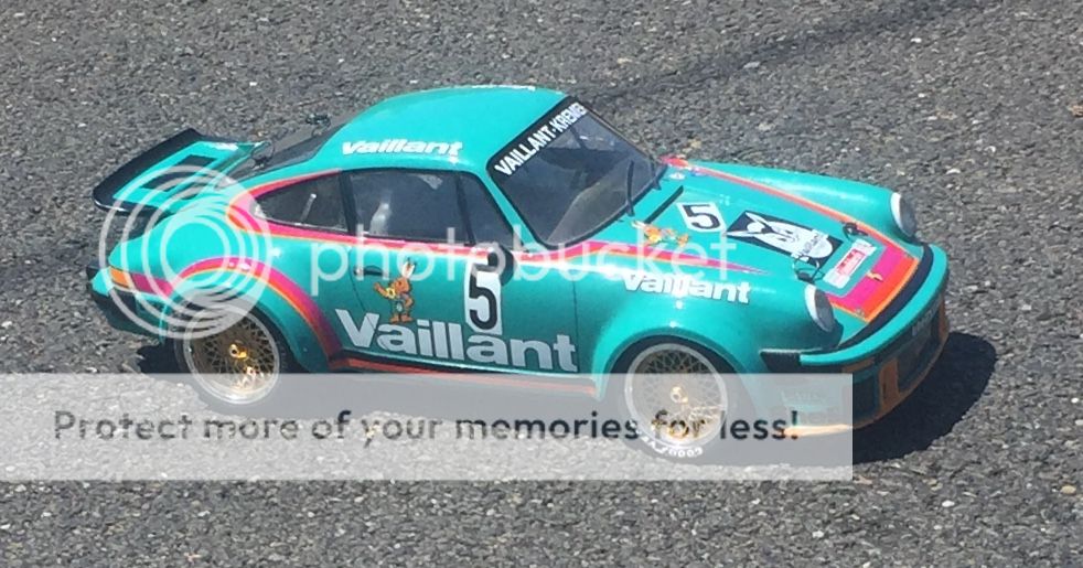

If you look at the real e50 wheels (see image below), you can't really see the '3-piece aspect' anyway - the lip/bolts are somewhat hidden compared to the LM wheels.
Once I've painted the centres on mine gold they should look pretty much the same.
The wheels are some that I found on ebay about the same time I bought the 40th anniversary 934, when I realised it came with the wrong wheels. Not sure of brand.
Tyres are HPI vintage, which have a taller sidewall on the outside which fits over a lip on the wheel rim.
The only thing wrong is that they are all the same offset, front and rear, and all the same width. I've squeezed on wide tyres in my photo and I think this will look ok for the shelf. For the fronts I was considering modifying the centres to reduce the offset somehow. Not got around to it yet.
