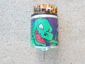

My personal favourite brushed motors are a 3 way tie between a 27t stock Trinity 'Revenge of the Monster' the Schumacher Flash 2 and the  12t double Demon Power King (RIP NIck Adams)
I think the Trinity slightly peaks ahead because of the charming yet naff drawing on the can.
Trinity RC 1:10 Electric Motors Inrunner for sale | In Stock | eBay
