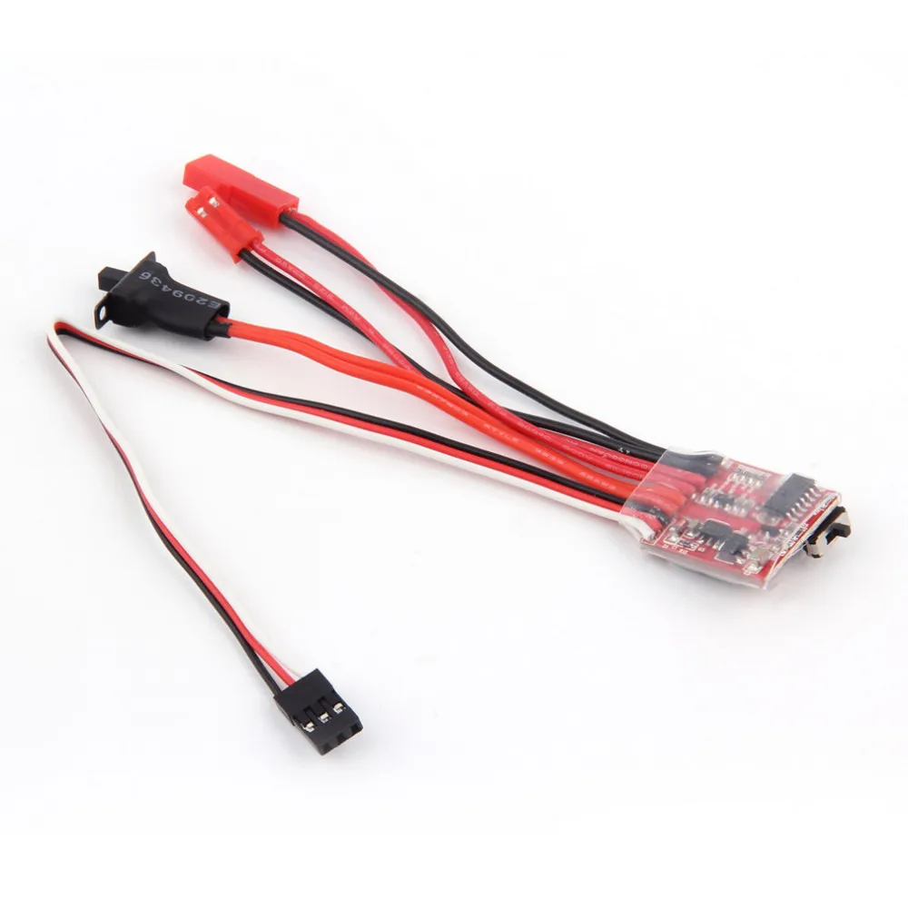

There are a good amount of cheap generic micro brushed esc's on amazon and banggood, but this one should the best for a crawler since it has instant reverse. I'm fairly certain that you could find someplace that stocks them in the UK as well. Some other options are the castle micro sidewinder and the Holmes BR mini, but they cost over 4x the amount of the one I linked.
Thanks, with a bit of browsing I found an identical-looking one on Banggood (photo of the circuit looks exactly the same) but it doesn't explicitly state that it has a LiPo cutoff.  I suppose I could try it with a LiPo alarm to see if it stops.  Thanks :)
