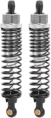

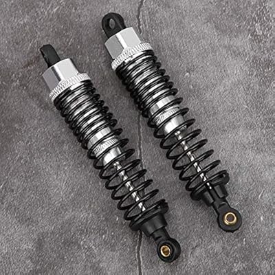

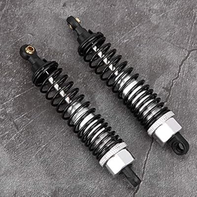

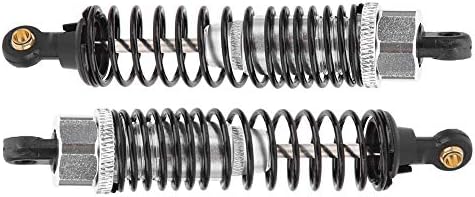

Those look awesome but from the UK... I can’t seem to find anywhere on a Canadian site to get them. I found these they seem great too but does not say oil or not.
2pcs RC Shock Damper, Absorber Shock Damper RC Car Replacement Parts 1:10 RC Car Parts (85mm)

Good to know... and how do you like them? Do they come pre oiled? And the bottoms press on to the ball stud or do you have screws with nuts mounting the bottom? And those are the 85’s I assume? Sorry lots of questions & hard to see. I often wondered how short you could go with the lunchbox shocks so the center of gravity is lower.
I'm  happy with them for the price.  The have a dribble of oil in them . I emptied them out and used Tamiya medium oil. The swivels came loose on mine and just press in , then bolt through.
I ordered 4 in an 85, should be here by Friday.... can’t really find any info or reviews on them tho. Did you have to buy extra hardware to mount them? I have the 4 left over “U” brackets in the kit still and some of the screws and nuts that were left from the build.
On 1/27/2021 at 5:08 PM, KEV THE REV said:
They are oil filled type . I have these on a few of my models including one of my Lunchies
