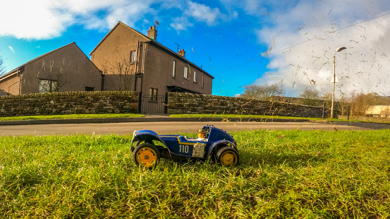

Before...
141274362-184836213328234-14925711066218
After
141401930-243909440627843-28406174433588

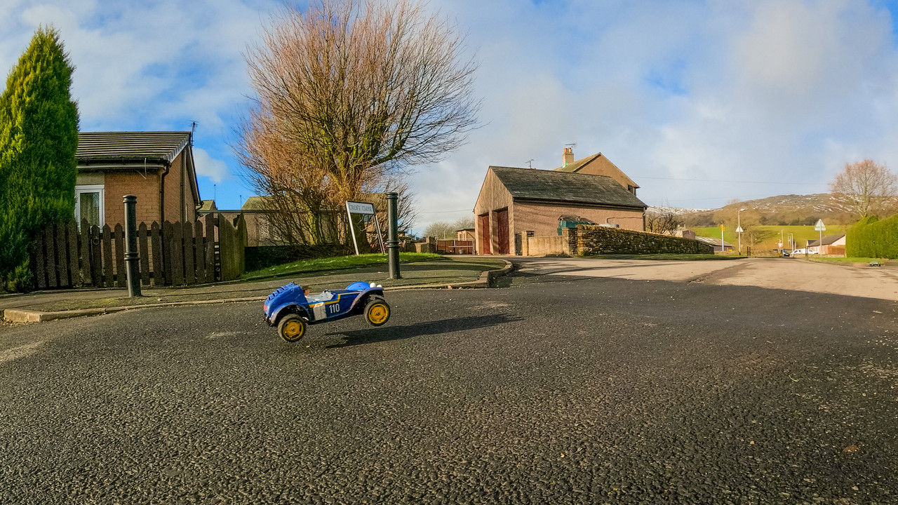

First run with the BL system, much much faster, just a little urban shakedown.
Wheelies very easily.

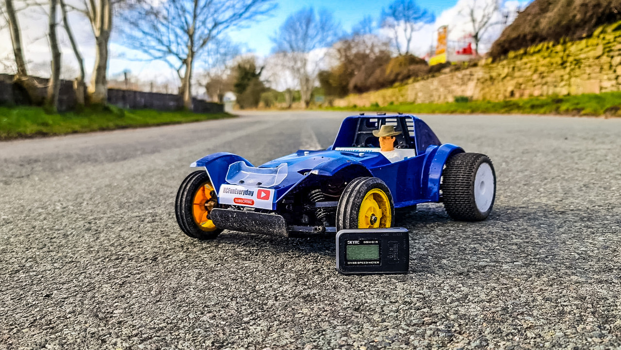

Gave the Holiday buggy it's first speed test, footage will follow in which you'll see all it wants to do is flip over, managed to hit 42mph though which on a 2s I think is quite impressive... I think one of my shock shafts is bent because they are really stiff and don't want to move, I think that contributed to the fact it wanted to flip over so much, definitely going to lower it, also going to make some attempt at aerodynamics, I kinda want to hit 50mph now and I will be extremely happy.
I was expecting about 32-33 based on my friends Timberwolf maxing out at 37.
It did have just a smidge more to give though, but between cars, wagons, flipping over and bumps and skidding, I didn't get what I'd consider a flat out clean run, ideally want to hold it flat for a good 5-10 seconds, I do have another spot to try though.
The big question, what's the fastest Holiday buggy known?

The footage of the speed run as promised, super happy.
From my research, the fastest Holiday buggy is 47.3.. So 48 is now my current goal, if that is achieved, I will aim for 54, so I am in the top ten fastest Tamiyas in the world :D

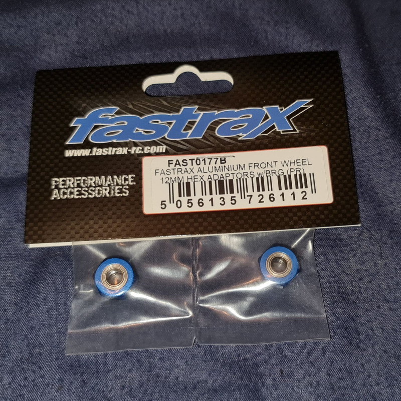

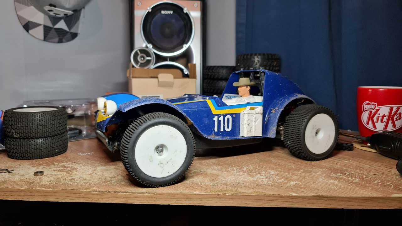

So I picked up some of these bearing to 12mm hex conversion hubs from Fastrax.
Unfortunately, they are quite poor, not a very good fit on the axle and not a very tight fit on the hex of the wheel, tried for several different wheels, they were all loose, my guess is it seems they are machined to a about 11.5mm then they 'hope' anodising adds the 0.5mm... It didn't!

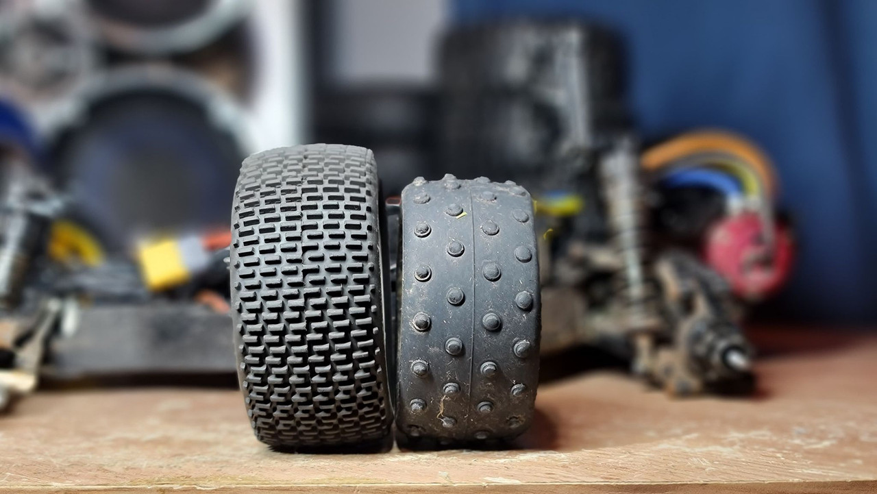

I took a quick picture with the new wheels and tyres mounted, unfortunately until I find a fix for the hubs or something, I will be running stock fronts and new rears.
147162099-425756971815155-86409264916356
I think it looks really cool though!
147841049-212236090613902-14269956710821
The extra height should definitely help me.
147254370-240332977720161-26595518012263
I think set about work on the shocks, I have shortened the rear by 8mm, then added a 5mm bump stop, so they have very limited travel, I am yet to do the fronts, but will get around to it, picture below demonstrates the difference.
147090423-792674004794196-70637180317556
The current wheel/tyre set up.

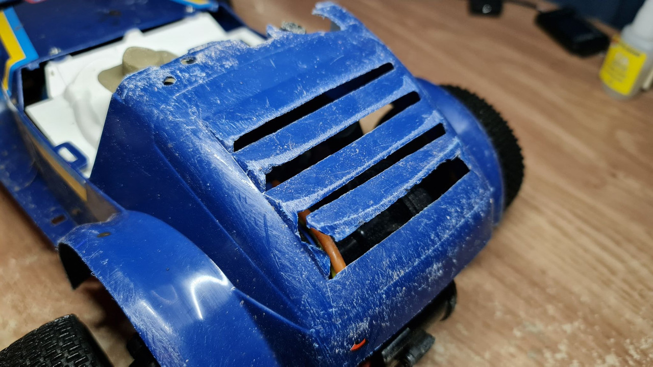

After doing some more testing tonight, a new body and body posts for the rear have been ordered, because, well....
147549981-227719029018034-28035568873822
147992336-1275580776170494-1270864121660
And I am very happy and proud to now officially be on the speed run list.
@Oh How Original the fastrax adaptors work great. My daughter has them on her DT02 with schumacher race wheels and has done hundreds of laps of racing on them with no issue even with a hot motor and HV LiPo.
However they are not a straight fit, you have to fit additional parts, shims and potentially drill out wheels etc to make them work.
The DT02 required a standard 5mm washer (greased) fitted behind the fastrax adaptors, then you must fit a greased shim in front. The 12mm hex drive Schumacher wheels needed a 5.1 - 5.2mm hole drilling through their centres so the wheels ran smoothly and cleared the axles but not large enough to introduce slop. Then you need to carefully tighten the nyloc until the wheel rotates smoothly BUT has no end float. We also used threadlock on the nut. Remember that normally a hex drive wheel is clamped to the drive hex, with these adaptors the wheel sits loosely on the adaptor and is only prevented from moving by the close contact of the nut. Hence the reason we use a greased 10x5mm (or 8x4) shim (schumacher) between nut and wheel. The schumacher slim race wheels now rotate perfectly on my daughters DT02 and there is no slop at all. We also fitted quality bearings as the supplied ones are junk.
Those adaptors are not designed for fitting without any fettling.

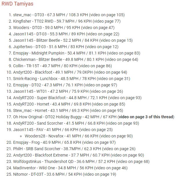

PS. I wouldn't read too much into that list of fastest Tamiyas...... The stated rules about videoing the speed run means many people can't be bothered. My buggies have run faster than most of those in that list and on brushed motors with NiCd batteries but I just couldn't be bothered spending ages trying to do a video. I just wait until we meet up and my brushed motors wupp their brushless and leave them perplexed :D
We can all get a buggy to go 50+mph in a straight line, the real gains is making it go around a corner under power. :lol:
And don't get me wrong, I enjoy doing the speed runs, I do GPS speed tests on all our cars regularly but for me it is mainly to test setup and compare gearing etc. The fact I can do 55mph in a Cougar on a brushed motor and 2S LiPo is largely irrelevant because I can only use that gearing for 1 minute before the ESC/motor overheat. For general running I use much lower gearing, typically max 35mph for racing on our garden track.

That's some good information about the Fastrax adapters, it really seems rather stupid they didn't just make them correctly in the first place though, I guess it's a budget brand and all, I kinda expected them to need something, because of the unconventional way the Tamiya fronts rotate.
Already drilled the wheels out so they do slide on, I will have a look for those shims and get some ordered.

The shims I used were left over from my Schumacher Couger new build (at xmas), I'll go measure them later and let you know what size they were. I don't think you can use a plain washer for those. Pretty sure I tried that and they were too thick and I ended up with no thread left to engage the nyloc, even more critical with the adaptors as the wheel is spinning against that nut so it is more likely to come off (hence the reason I also used threadlock on them. I did use a plain 5mm washer behind the adaptor though. I made sure to use a light grease on the washers and shims to make sure they didn't bind up.
Yeah I know what you mean about those adaptors but in their defence, I think Fastrax originally did them for shelf queens rather than runners and they are not specific to a DT02 either so axle lengths differ from buggy to buggy by a 1mm or two so I forgive them the need to do a bit of fettling to make them work. As you say, they really open up the wheel options. My daughter loves the black Schumacher race wheels. I just ordered her a set of rears so they match the fronts.

The front of the Holiday Buggy lifts at speed once a bit of airflow gets under those guards.

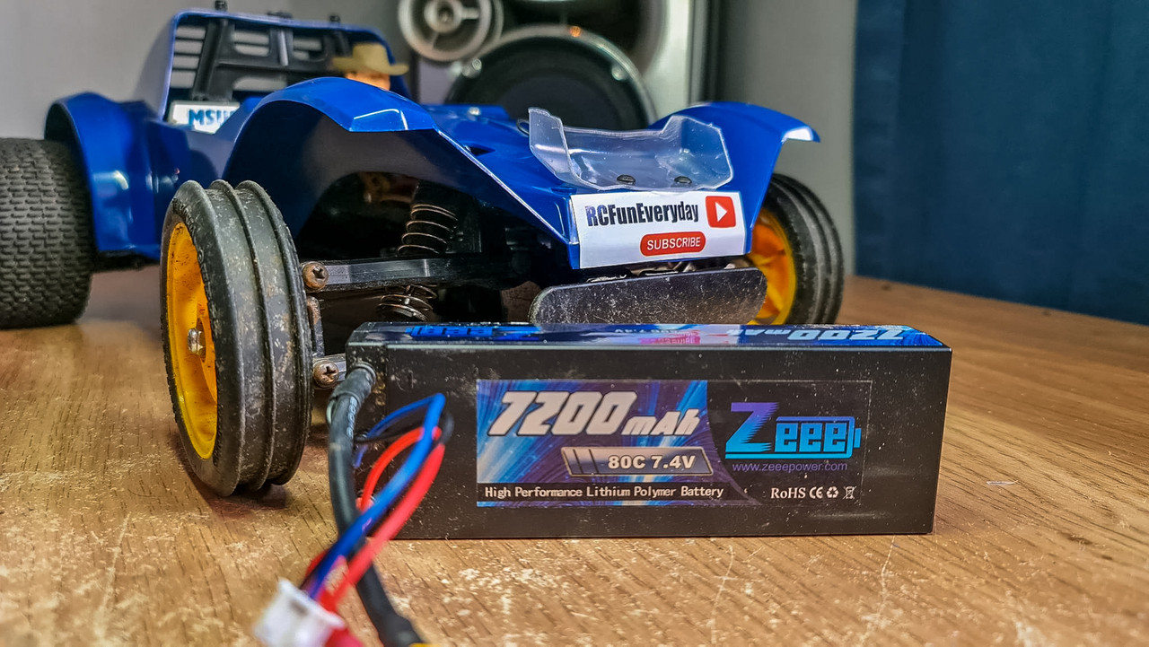

 New body and mounts fitted today, along with a Schumacher mini wing, thanks to DMS Racing for helping me with one that would fit between the arches.
Then tested out my new Zeee 2s 7200 80C and I have set a new PB with it AND an unofficial world record and that's going very slightly uphill as you'll see in the coming video and episode 3 of the WR HB project 😄
