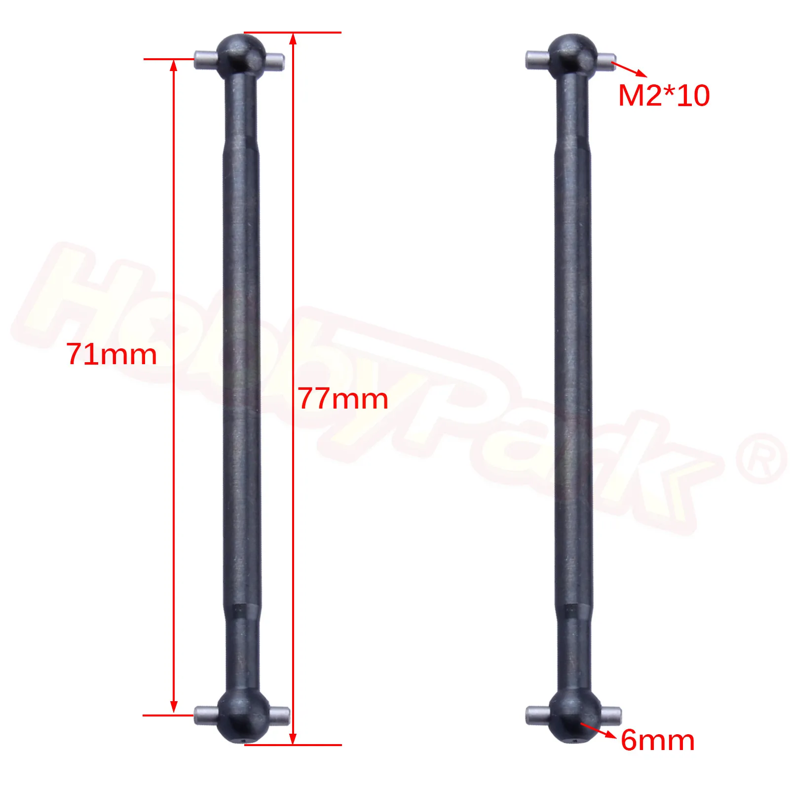

Is this what you need
Hi, and thanks all for the replies. This looks similar and appears to be the right length but lacks the same radial markings on the shaft - does this matter? Any ideas what kit this item came with? Vagueley considering selling what I have and putting money into a re-re!
Cheers, P.
Quite unusual to see an original Hotshot driveshaft without the engraved lines at each end. I wonder if this is an aftermarket copy of some kind? Most original examples had two engraved lines at each end of the tube, but the very early examples had one engraved line at each end. I have never seen an example with no lines at all.
You could use vintage Supershot or Hotshot 2 front driveshafts if aesthetics isnt an issue to you?
Not sure if re-re driveshafts can be used in conjunction with vintage drivecups as it's not something I have ever tried.
It came with a boomerang I restored, seemed to have some hotshot parts mixed in that I didn’t use. Not 100% sure what it’s fro
