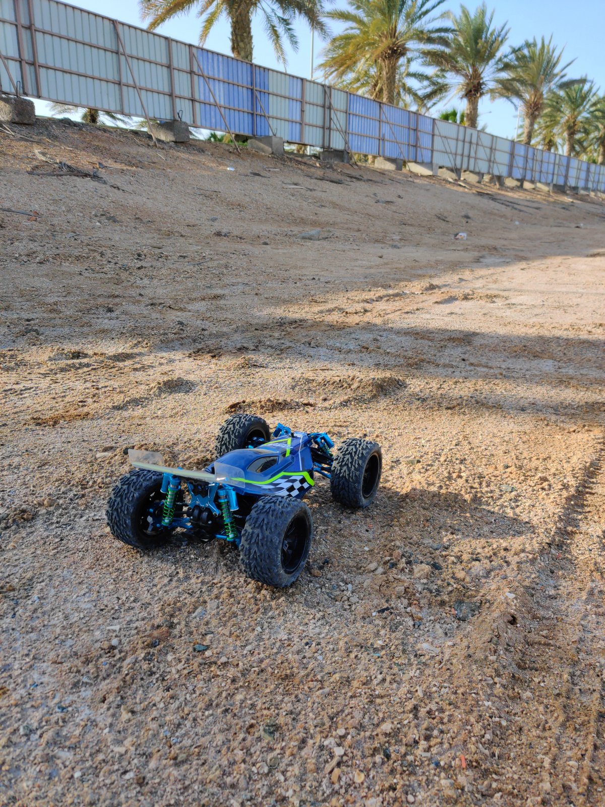

I have the exact same setup, except for one difference: I'm using the standard TT02B 'chunky' diff outdrives, and CVDs that have bigger ends on the diff side to properly fit into those outdrive cups. That works a treat, and I've never had anything pop out, despite having monster wheels on my TT02B and driving on rough terrian, in anger, quite often.
This is the best pic I have at hand; hopefully you can see the (proper) mating between the diff cup and the CVD:

Do you have a pic of this on the monster wheels please? I'm toying with getting the Neo Scorcher and if it can run big wheels that might make my mind up for me!
