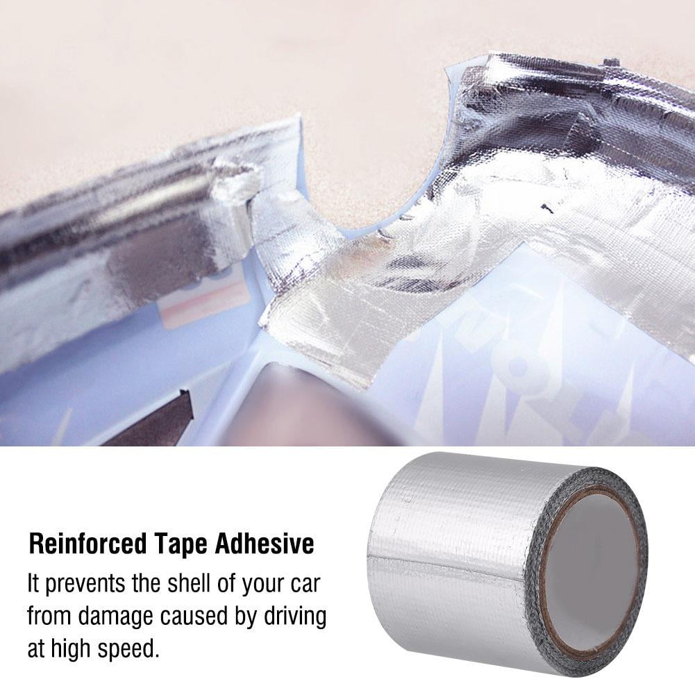

So on a lot of Sites like Banggood or Ebay you find Aluminum Tape for reinforcing Lexanbodies.
Why do "everybody" use Aluminum Tape??
I`ve ordered this Tape:
https://www.amazon.de/Aluminium-Klebeband-netzverstärkt-Lüftungs-Klimaanlagen/dp/B06Y14SLN7/ref=trb_chk_auth?__mk_de_DE=ÅMÅŽÕÑ&dchild=1&keywords=aluminium+klebeband&qid=1618326184&sr=8-17&openid.assoc_handle=amazon_checkout_de&openid.claimed_id=https%3A%2F%2Fwww.amazon.de%2Fap%2Fid%2Famzn1.account.AFJBRN36CHYVJG2JC5BRIO3JYWYA&openid.identity=https%3A%2F%2Fwww.amazon.de%2Fap%2Fid%2Famzn1.account.AFJBRN36CHYVJG2JC5BRIO3JYWYA&openid.mode=id_res&openid.ns=http%3A%2F%2Fspecs.openid.net%2Fauth%2F2.0&openid.op_endpoint=https%3A%2F%2Fwww.amazon.de%2Fap%2Fsignin&openid.response_nonce=2021-04-13T15%3A05%3A04Z2988856154929035734&openid.return_to=https%3A%2F%2Fwww.amazon.de%2FAluminium-Klebeband-netzverst%C3%A4rkt-L%C3%BCftungs-Klimaanlagen%2Fdp%2FB06Y14SLN7%2Fref%3Dtrb_chk_auth%3F__mk_de_DE%3D%C3%85M%C3%85%C5%BD%C3%95%C3%91%26dchild%3D1%26keywords%3Daluminium%2Bklebeband%26qid%3D1618326184%26sr%3D8-17%26trb_auth%3D1%26trb_open%3D1%26trb_bid%3Dbuy-now-button&openid.signed=assoc_handle%2Cclaimed_id%2Cidentity%2Cmode%2Cns%2Cop_endpoint%2Cresponse_nonce%2Creturn_to%2CsiteState%2Cns.pape%2Cpape.auth_policies%2Cpape.auth_time%2Csigned&openid.ns.pape=http%3A%2F%2Fspecs.openid.net%2Fextensions%2Fpape%2F1.0&openid.pape.auth_policies=http%3A%2F%2Fschemas.openid.net%2Fpape%2Fpolicies%2F2007%2F06%2Fnone&openid.pape.auth_time=2021-04-13T15%3A05%3A04Z&openid.sig=weCUfVxeYpcC7A%2Ft6TUSgJDKeeX9X%2FABrQTII85lamU%3D&serial=&siteState=|hasWorkingJavascript.1
But what is the advantage over normal goilla- crocodile-, gaffa, duckt- or whatevertape?
This is what other People use:
One reason I can think of is that aluminium tape has no elasticity, meaning when you stick it to uneven surfaces with complicated curves (like the inside of a car body) it conforms to the shape and doesn't try to return to its previous shape, meaning it stays stuck.
Also, if you don't quite stick it right into a sharp corner, you can press it in afterwardstand it will stretch, and the lack of elasticity means it doesn't eventually pop back out. This may only be possible with non-fibre reinforced versions, however, as the fibres may resist stretching.
When quickly repairing bodies during races I used aluminum tape.  Works well.. until you crash again.  Best reinforcement imho is to cut your foam bumpers to match the body's inner  contour and secure them to your body posts/chassis.
