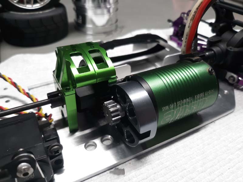

For the center trans I found a complete replacement Axial Exo bulkhead and motor mount. Works out great, I already had a few spare spurs, and it uses standard AX10 stuff of which I have a ton laying around, so it gives me the option of 3 center gear sizes, and a center diff or locked with a diff locker. Works so well, I ordered the only other one I could find on Ebay in the US. Genius, wish I had thought of this earlier. The green color....hmmmm....
Mounted up the bulkheads and the center trans. Took a bit of fiddling, I wanted to make sure I had the right length dogbones for all the different wheelbase options. Which I do!

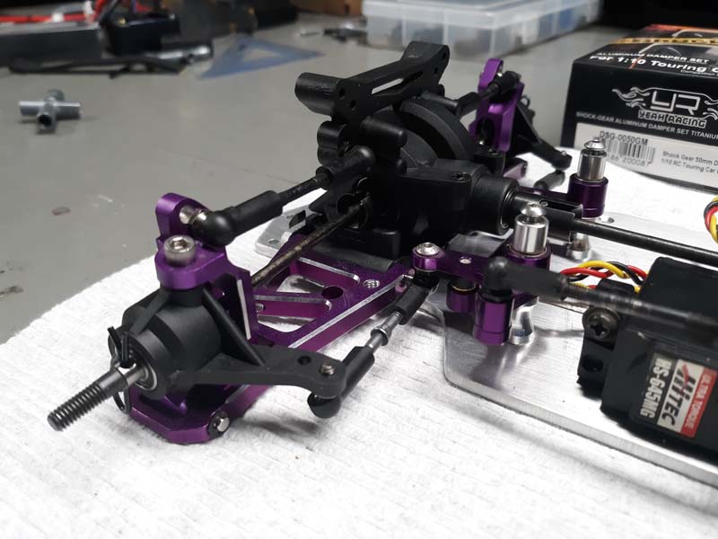

Tried to do something different with the battery tray this time. Instead of bolting a huge, heavy tray to the chassis, I bent up some aluminum and made some brackets to hold the battery pack. Works like a charm and seems solid enough, I drilled out a few sets of holes so I can run my 90C packs on drag day, and larger, full size packs on parking lot days.
Whoa...pulled apart the diff assemblies to check and re-grease and found a 1-way in the front! Nice! Won't need it for drag racing though, I just put in an open diff for now front and rear. Tempted to lock them up, but with drag season winding down, decided to build it for parking lot fun (Though it'll get a few passes I'm sure)
Assembling the chassis ... shocks have arrived (50mm) and decided to embrace the green and purple... it kinda grew on me. Dropped in a Castle 3800 because A) it matched the color and B) it's all I have. :)
Need to finish up the chassis details and figure out an upper brace. Bumper mount is en-route as well.
