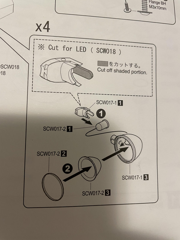

Does the lenses have to be glued onto the buckets/housings? Haven't come this far with mine yet, but I can't see any reference to glue in the manual.
No need for glue. There is one part which is to be cut to let room for the led, and it acts like a clip when you put it in place over the led.

You are talking about the bulb right? But what about the clear lens in front of the bucket/housing, part #2 in the picture below?
The clear lenses snap into the buckets. I have not driven my buggy hard yet, but they feel firmly in place.
no need for glue as well for the clear lens. You juts have to push it inside, it is like clipped inside, as the housing as a form to maintain it. Not sure you can remove it afterwards. If it doesn't enter properly, it is likely because you have the led wrongly positioned inside..
Thanks, then I understand! The diameter looked a bit to big to get into the bucket, but then I just need to push harder (after I have assembled the leds).
