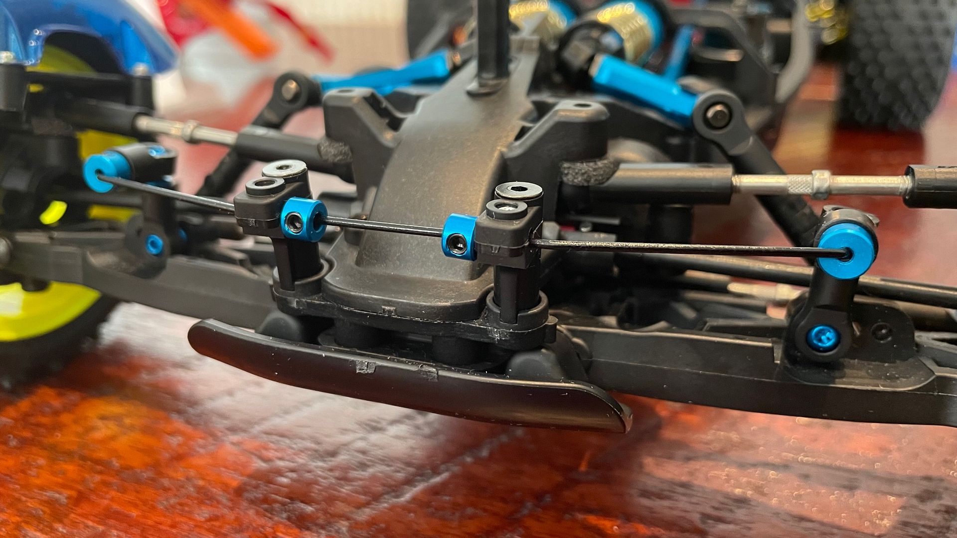

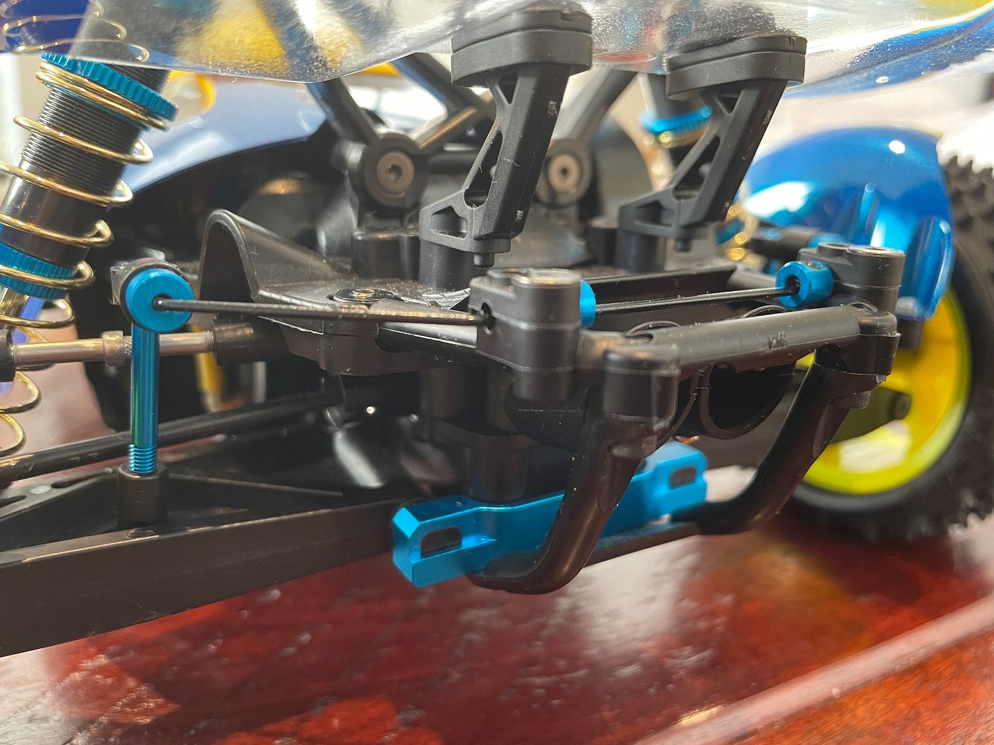

Installed Sway Bars & alloy ball diff retaining nut. IMHO, this alloy nut is the most important upgrade for this kit. The plastic retaining nut just not up to the task. Another USD18 spent. I made the mistake of just getting one. Installed for the front first. Getting a second one for the rear.

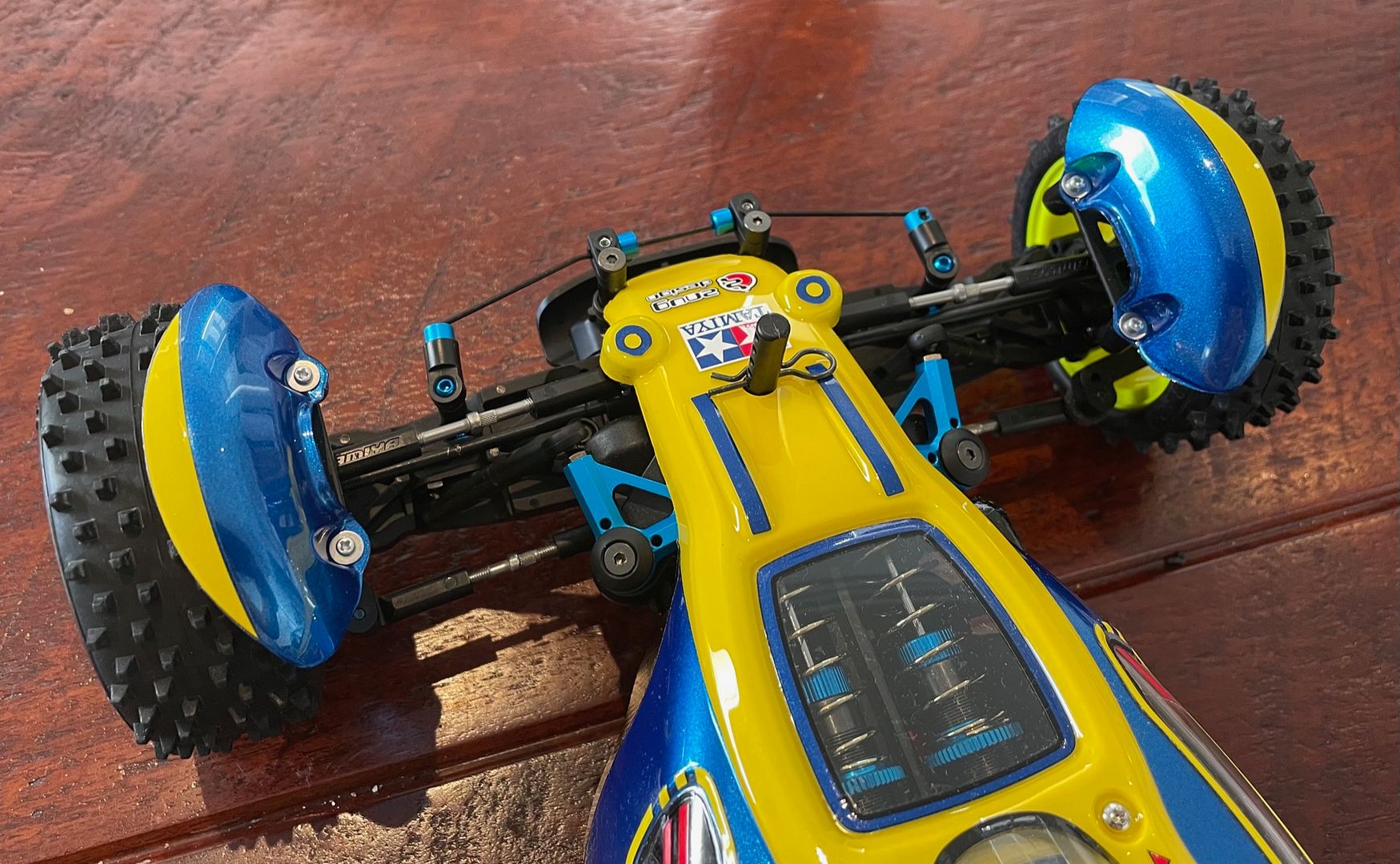

Ok, I finally finished my build over several evenings of an hour here a coupe hours there. I still need to paint the body. It's been especially rainy here in So Cal so not the best weather for painting. I've added the slipper clutch 22031, front universals 22028, TT02B/DF03 dampers 54993 and I swapped out the external bearings with rubber sealed versions. I'm not going to post any pics yet because I'd just be posting the same thing as everyone else.
After building the car, it seems there's a lot more disassembly needed to do things. If you want to replace the motor, the whole rear has to come apart. If you don't install the slipper during your build, you have to disassemble the whole top/rear of the chassis. Also, what's with the diff adjuster cap? I mean they couldn't find a better way to attach this? Time to buy some K parts trees to replace the little cap when it falls off after a hard landing.
I do like the plastics. Not too brittle and not soft like the standard Tamiya ABS. I really like the uniqueness of the chassis. It's definitely something different. Once it drys out a bit, I'll paint the body and take it out for a spin. Also, I'm not doing box art...probably like a modified box art-ish paint job. :D
