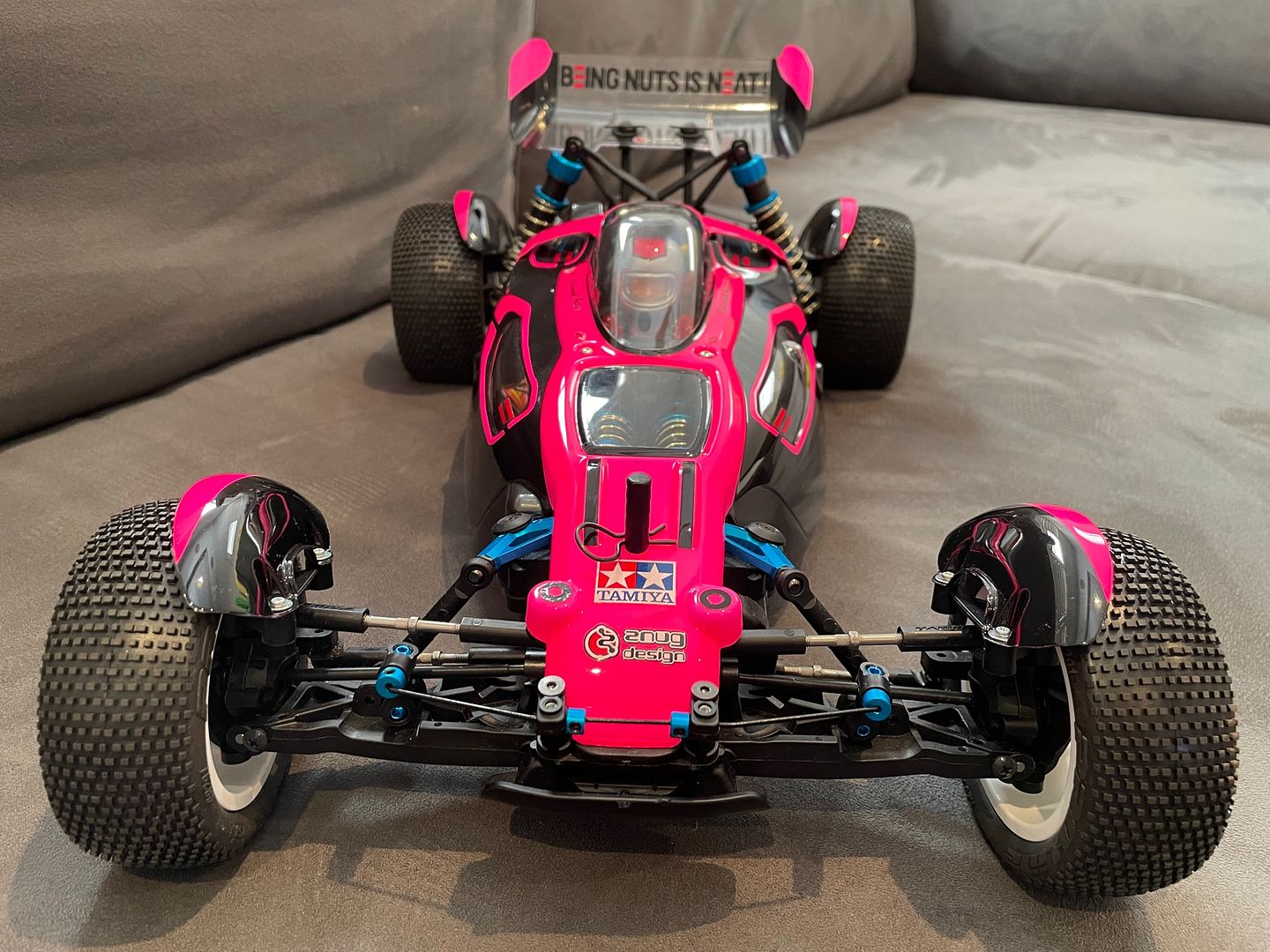

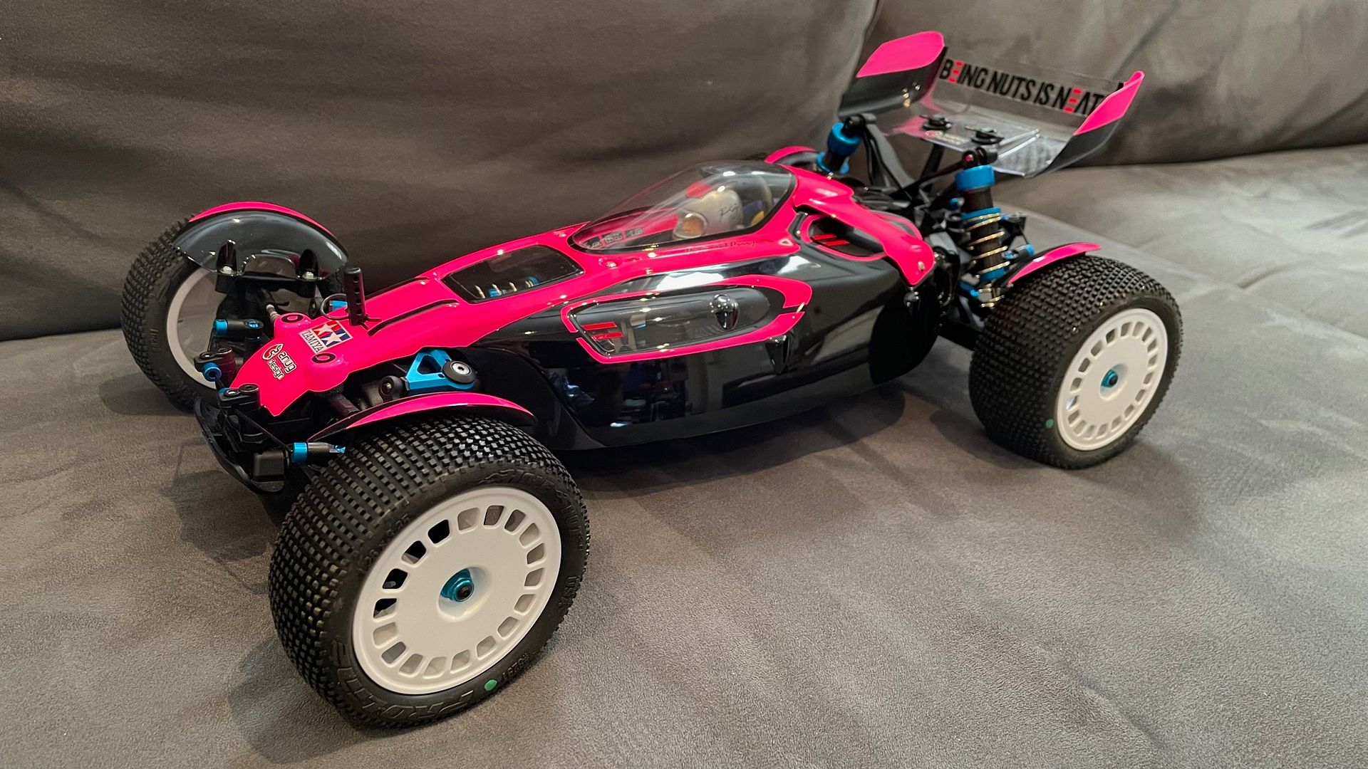

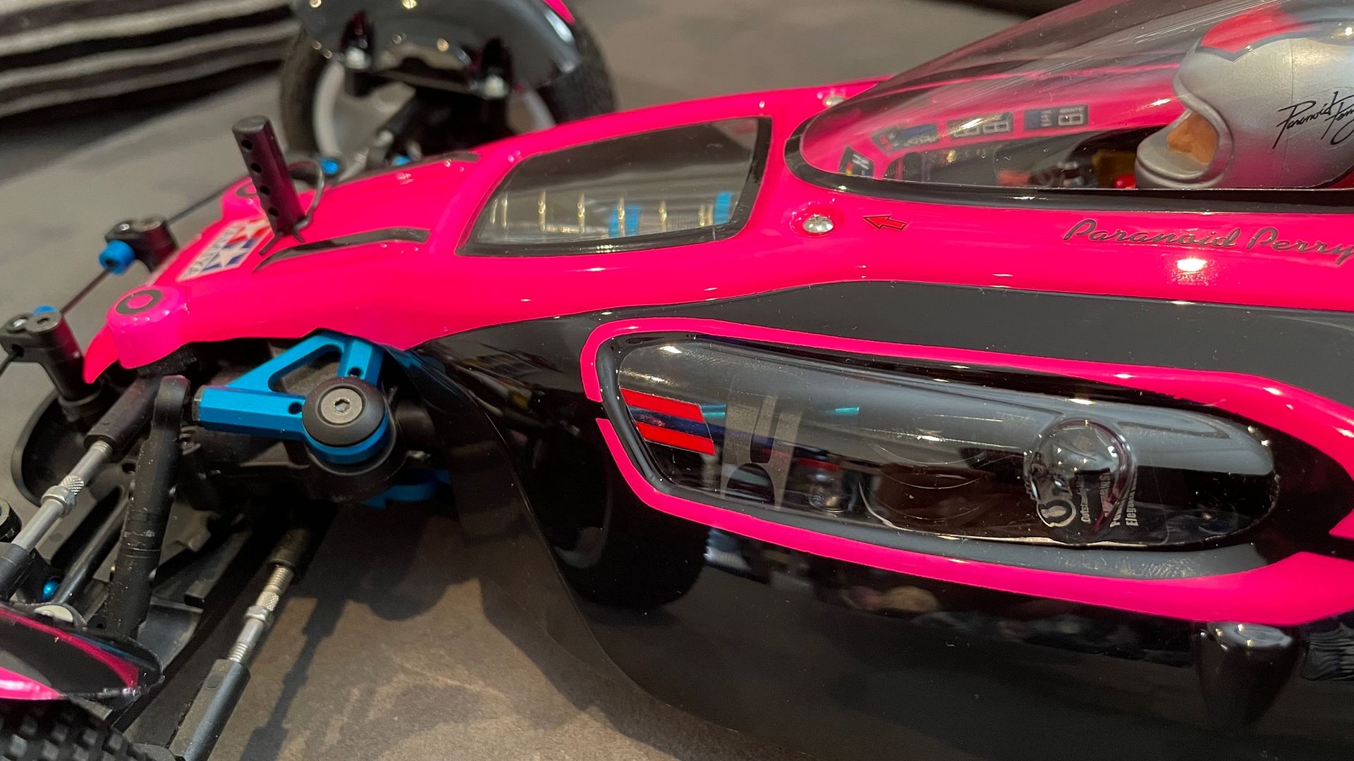

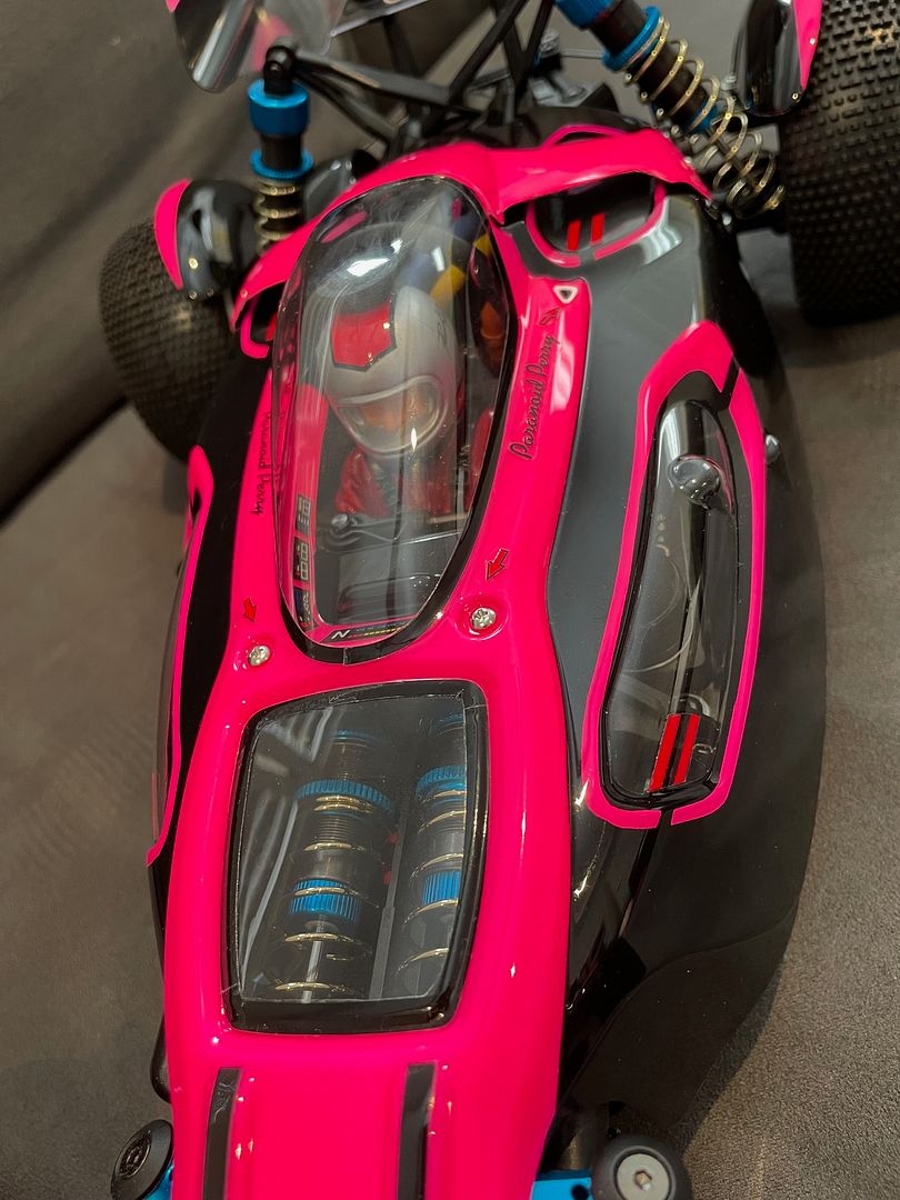

Done(ish):
I used a Rawspeed RC body intended for the TLR 22 5.0. Paint is Tamiya PS 53 -> 59 -> 23, top to back.
It’s not a perfect fit, but it’s the least ugly of the cab forward shells. It doesn’t extend down the tub walls as far as I’d hoped, and the back of the tub is not covered. I was hoping the nose was curved down more. Maybe a heat gun can fix that.  But it was $18, so I’m not complaining. Next weekend I’ll run it!
If anyone is wondering if the VQS Hi-Cap dampers fit out of the box the answer is yes. For the fronts you either swap the shaft to the kit CVA shaft or fit a longer ball end connector to get the proper eye to eye. The stroke is long enough.
Black Pink edition :D

Pink rims are impossible to find. Black rims on the way from HK. Pink stickers for the main logo on the way from Canada.

Looks amazing!
Have you thought about dying the white rims pink? I dyed my Super Astute rims pink using Rit Super Pink dye and I reckon that could be a good match.
23 minutes ago, jonboy1 said:
Looks amazing!
jonboy1,
Are you saying this white wheel can be dyed ? Thanks !
