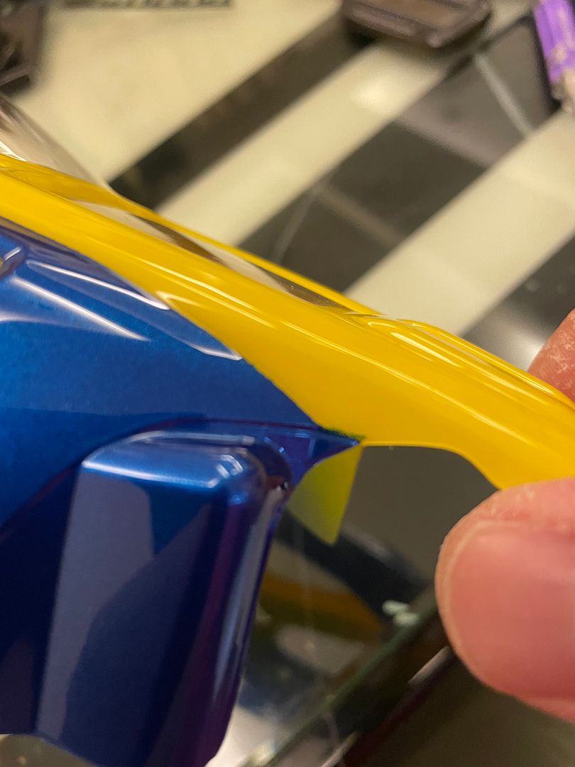

It's a SE variant with a factory painted body that sells for more. However, I am not so happy with the factory painter (facepalm)
No backing paint
Really ?
  • Sad 1
No backing paint
Really ?
Don’t think Tamiya pre painted bodies are backed? Agree that the masking is 💩. Bit like mine🤫

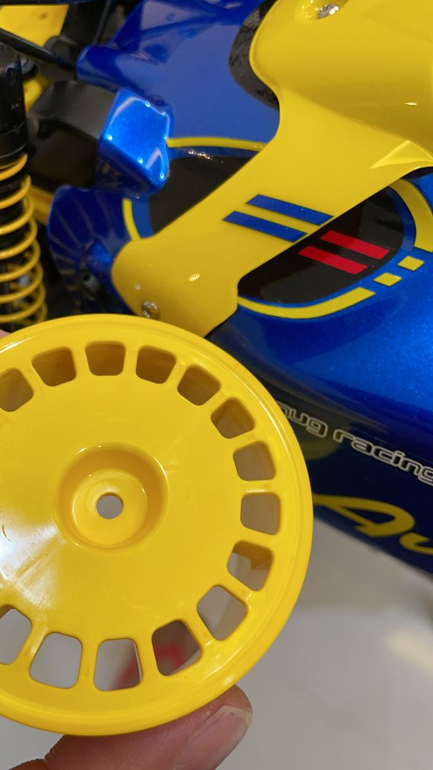

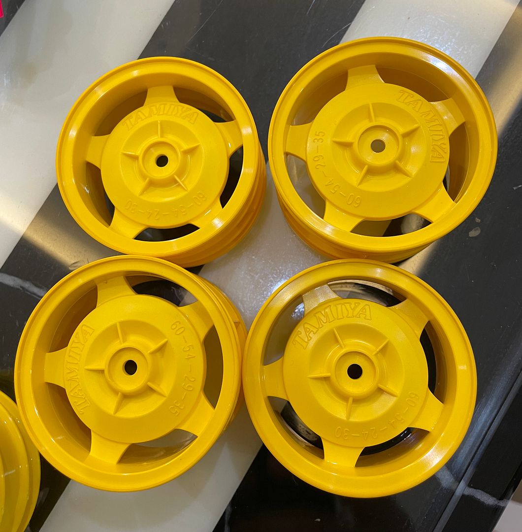

Did some cooking to match wheel color to the body :
The RIT Lemon Yellow + 15 minutes of slow simmer seems to be a fairly close match to the PS6
