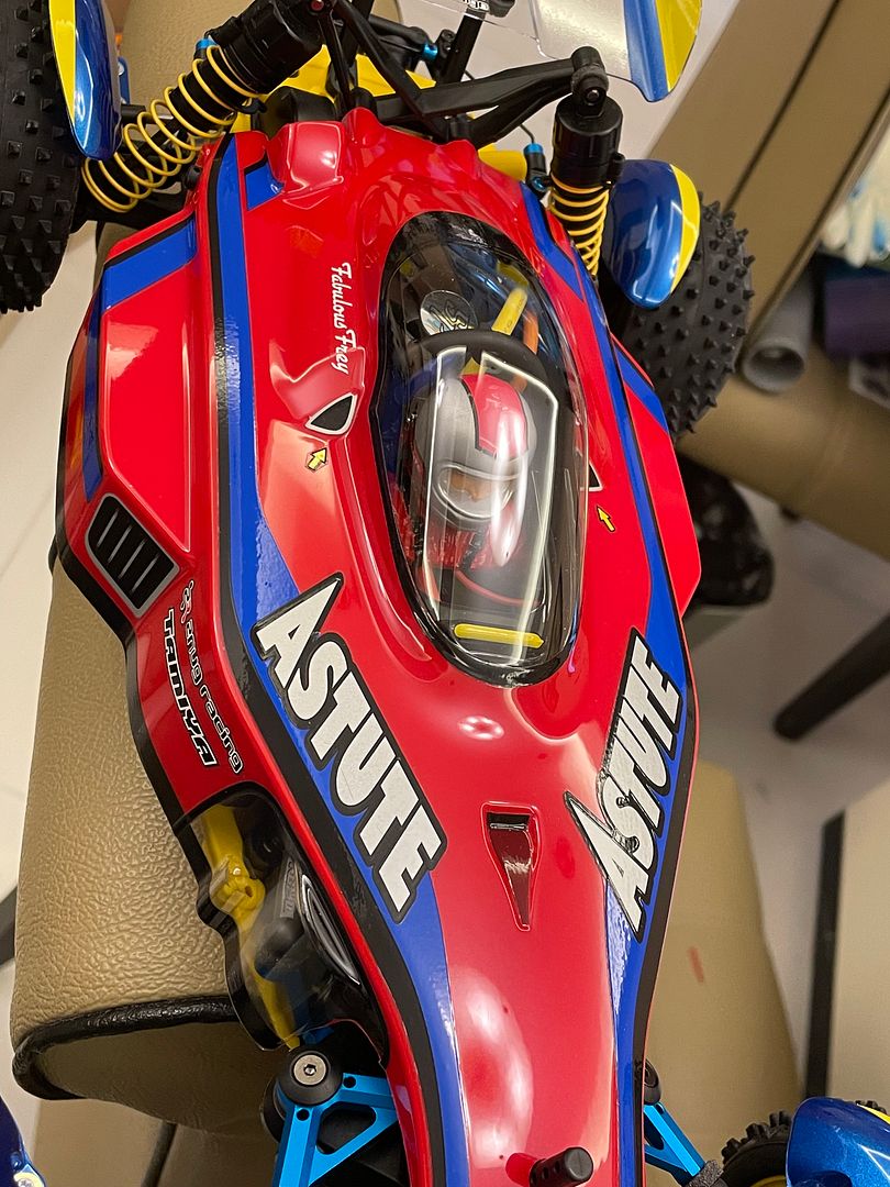

This is my just finished painted body kit (driver is still in progress). Being an off road buggy I thought no need for crazy fast speeds, so I opted for Tamiya's 15.5 brushless motor, paired with TBLE-04S esc. I used the kit supplied 17 tooth pinion, and programmed the esc to be in brushless mode. The result is a little too slow for my liking. Should I just use a bigger pinion? Or upgrade to the 10.5 motor? The motor's manual states that with 10.5 the TBLE-02S esc would require the cooling fan hopup (45063), I wonder if that's also the case with the TBLE-04S esc I'm using.
The car is hopped up with the slipper clutch and aluminum diff nuts. The slipper is not loose so no power loss there. Another confusing issue  - the slipper instructions say to use with 48 pitch pinion, and it meshes perfectly with the kit supplied pinion, which means the kit supplied pinion and spur are 48 pitch, right? So why does the car manual say "use module 06 pinion gear" in the setting up section on page 29?
