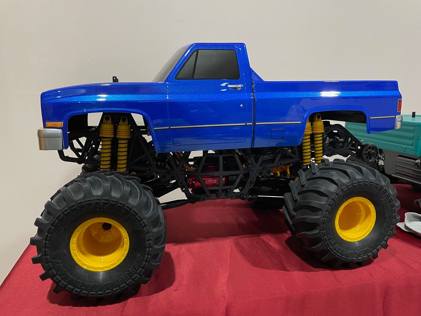

I just looked into these again and apparently there is now a kit version available now without electronics (exactly what you have I assume)?  They have them in stock in the US and the price is really hard to pass up...I might have to order one of these guys.  Comes with the C10 body painted in blue which is cool, I actually think the body is pretty good looking.  The truck has a great scale look overall now that I look at it a bit more.  Wheels and tires look great too.   I keep telling myself I don't need anything new and to just work on what I have, but how can I pass this up?  Seems like a good deal for a nice truck.  Wish I never saw this thread now :)

I haven't fully decided on a body yet, I went for the Toyota version because if I don't fit the Toyota body on the MTX-1, I'll at least use it for something else.  The C10 body is good but I don't like the smoked windows, and I already have a nice Clod hardbody in the same blue and I can't decide what to do with that, let alone a polycarb version.  If it came as a clear body it would have been a no-brainer but I can't be bothered to sell on a body I won't use.
